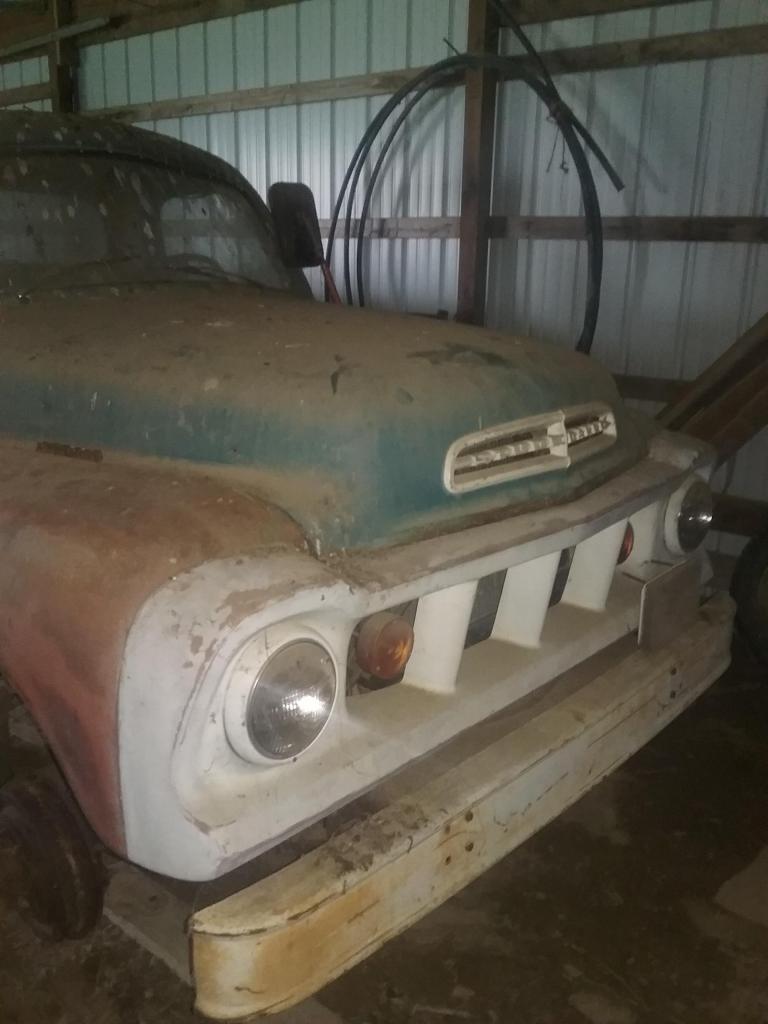

      Thanks for the info.. had my 63 transtar Click image for larger version
ID:	1853123 mobil until tire issue.. but I'll figure it out Click image for larger version
        Nice, it looks like a Standard Cab 8E13, and about the only clue that it is a '63 or '64, that is different than mine is the Amber Parking and Turn Indicator Light Lenses and different Housings.
        Yours was not ordered with Class "A" fender top Turn Signals, is that because it has the Rare 9 Ft. Pickup Box?
        Most Flatbeds and Box Vans would have the Class "A" Type Front and Rear required in most States possibly dependent on Width.
          Came with no bed.. my grandfather purchased it new.. and added a wooden bed.. sorry i don't have a better pic..
