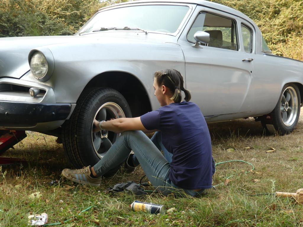

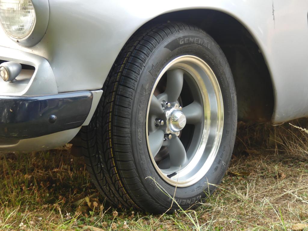

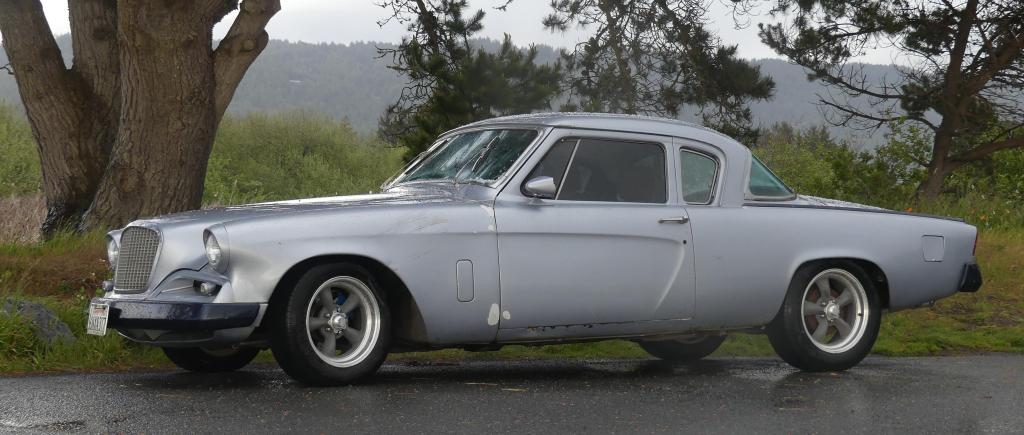

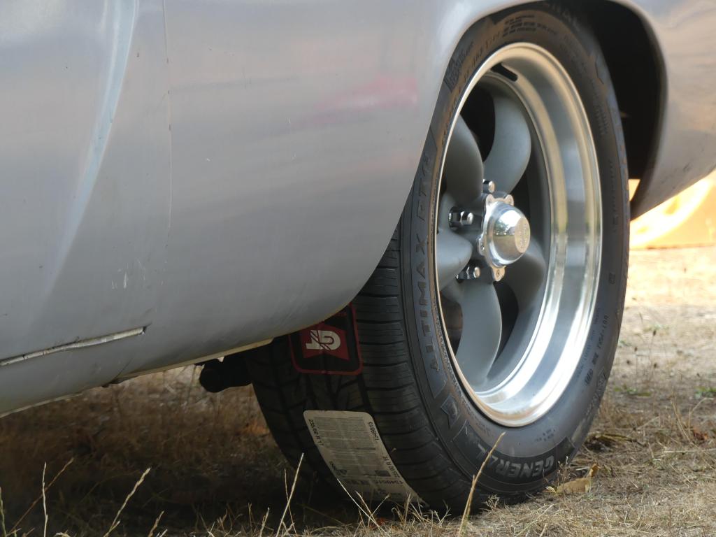

            I got mine from TireRack maybe a year ago, with tires (Continental True Contact Tours), mounted, balanced, lug nuts, and bearing caps for $1,194.58 shipped. Wheels: American Racing Torque Thrust IIs, Front 16x7 with 4" backspacing. Rear: 17x8 with 5.48" backspacing. Tires: Front 215x60x16, Rear 235x60x17.
            I have always loved these wheels. The IIs show a little more spoke and a little less rim that originals, and come in more sizes. In particular, the 5.48" rear backspacing is absolutely necessary to fit in fenders. No one else that I found has off the shelf wheels with that much, and only the 17x8s came with that much. These are also about the lightest weight wheels available from anyone at most any cost.
            I cross referenced the Tire Rack site with the American Racing site to get all the info I wanted. And I think AM orders these in batches, so they may be typically out of stock, but they let me know when I could expect them.
            At the time I was just outa hernia surgery, so my 6' tall firefighter grand daughter did the work for me!
            So I got exactly what I wanted, but didn't have a choice!
