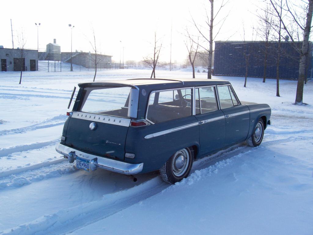

    Does your car look like the one in the picture? If it does, then it is probably the same car that I sold 8 years ago.

              Yes it does! Did you sell it to John Buhlman? And if you did, can you give me any history on the car?

                          Yes I did. I bought the car in 2007 from a guy in Northern Minnesota, but the car had come from Oregon or Washington at some point. I didn't have the car that long and ended up selling because I didn't drive it very often, plus I had two other Lark wagons at the time. I always liked the car and it's one of the few that I've regretted selling.
