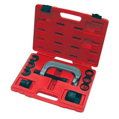

        I used the tool in the link below with an air impact and it made the job much easier.
        Free Shipping - SPC Performance Upper Control Arm Bushing Service Sets with qualifying orders of $109. Shop Bushing and Bearing Installation and Removal Tools at Summit Racing.
          I used a a frame bushing tool made by OTC that worked very well. OTC-7068. I've noticed cheaper versions offered by off shore companies.

            The bushing tool is the way to go..
            Place the A-frames in a vice and destroy the old bushing rubber with a drill bit, punch the old shells out, clean the frames up and use the tool to install new bushings.
