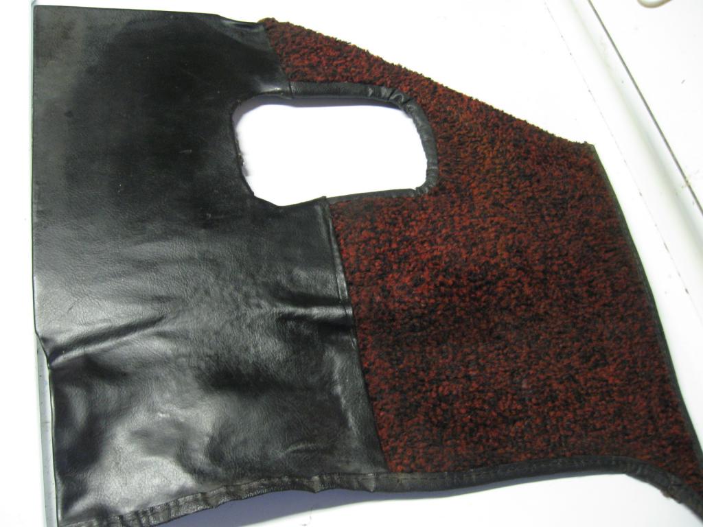

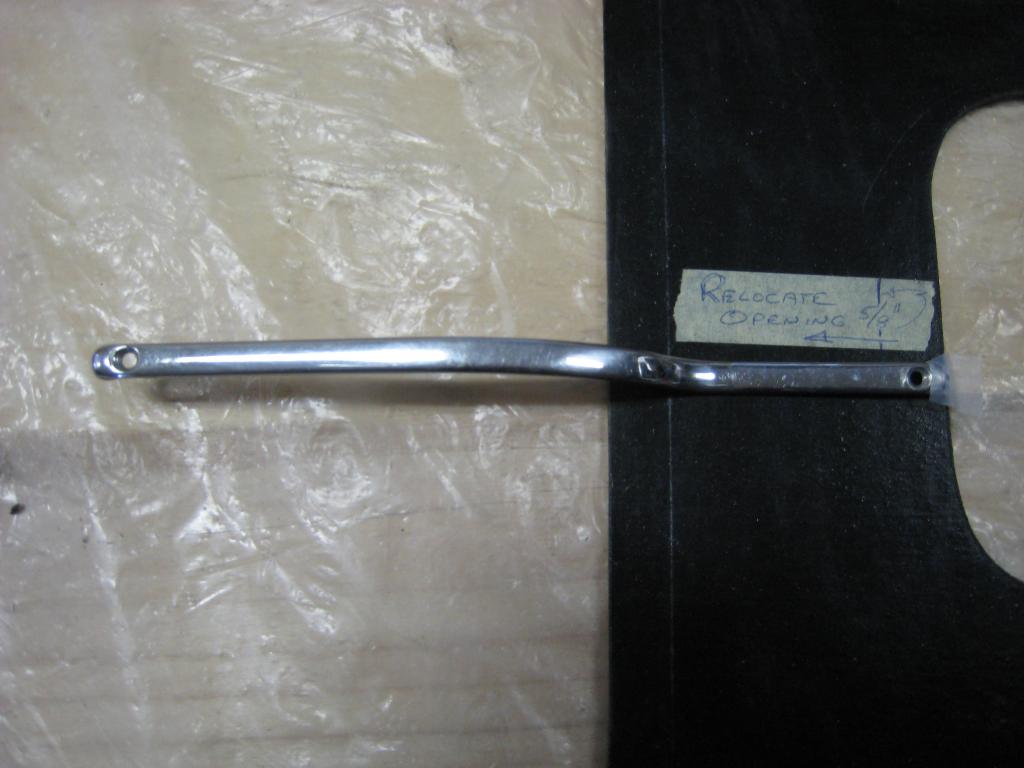

This is the best I can do for now. The 1st picture is of the board stock foundation to which the vinyl/carpet covering is glued. Note the adjustment noted on the masking tape. The 2nd shows the chrome stip that covers the division between vinyl and carpet.
I can't find the NOS '64 coverings that I had - must have sold them. Maybe someone else can post a photo of the '63 installed appearance.
Make the foundation to suit your specific car dimensionally.
I definitely do not have those kick panel boards. But I do have the chrome trim laying around. I didn't know what they went to.1 Family owned 63 Studebaker Avanti 63r-1705 White with Orange interior , R2 4 speed.
Just purchased 63r-3623 R2 was a auto now dressed to a R3 with a4speed.
its stainless I now understand why i see glue on the curved parts, there is no board in that spot.1 Family owned 63 Studebaker Avanti 63r-1705 White with Orange interior , R2 4 speed.
