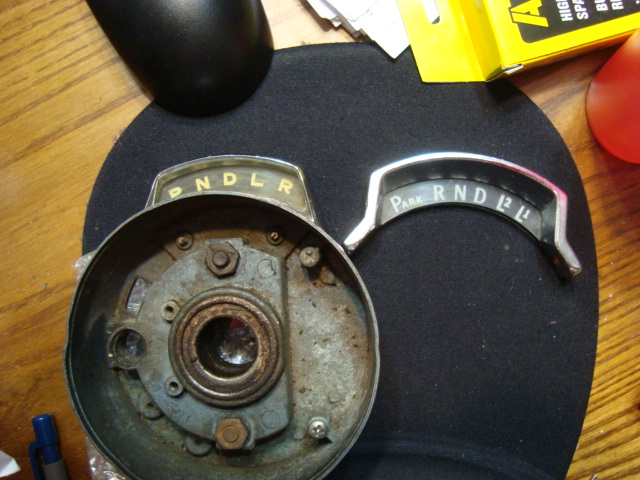

            Thank you Trebliq. I found the picture below for a dial indicator, as I call it.I bought this item from JEGS, a little expensive, especially since I was going to modify it. It cost $18.99 (JEGS p/n 898-FR20010NOK). I was able to easily cut it down to match the Studebaker chrome housing and it slipped right in. The letters are silk screened on, so you do need to be careful of the scratching the letters in the cutting down process and for me it had all the correct letters I needed for the GM 700 tranny. "P" was lost in cutting down, but that was a minor issue to me.
            Mark
              Mark
