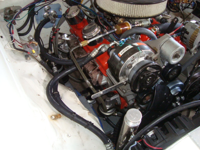

  • MAN!! This stuff really works!!! I bought some header wrap based on a suggestion from another member:
    It made a humongous difference. The temp of the AC dryer has dropped about 100 degrees!!! That's amazing!!! I also figured that one of the reasons for the high temps under the hood was as a result of the fact that I didn't have a mechanical fan??? I started to think about it.....then I thought to myself, although I have those nice electric fans on the radiator it doesn't really help with the overall engine temps. I thought to myself...if the engine had an mechanical fan it would continuously blow air "back" around the engine. The electrical fans do a good job of "pulling" air through the radiator but they don't really move any air back to the engine. So I installed the mechanical fan that I had originally put on the engine. It's one of those reverse rotation fans. :
ID:	1708627Click image for larger version
    After I installed the mechanical fan and started the engine I definitely noticed a lot more "air" being pushed back around the sides of the engine. That's exactly what I wanted. This air movement would force "cooler" air past the exhaust manifolds and past the AC dryer and the brake lines. Even though the air being pushed backwards would be 180 degree air...it would still be much cooler than the static air temp around the manifolds!!
ID:	1708629Click image for larger version
    I also rerouted the fuel line. When I first got the engine running (LAST YEAR) I was in a hurry to get the car home. I quickly bent a piece of fuel pipe to get fuel to the carb. But after all the heat problems I decided the reroute the fuel line to decrease the amount of "heat" it absorbed.
    I've run the engine a few times since all these changes and the electric fans actually turn themselves "off" as it sits there idling in the driveway. I LOVE IT!!!! That's the way it sould be!!

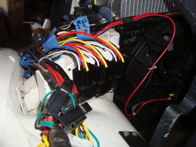

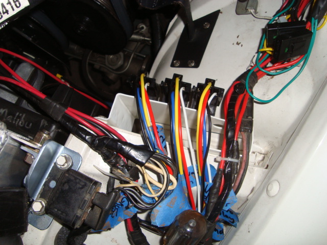

    • That came out nice. I still need to connect the wires but that pretty simple!!:
ID:	1708648Click image for larger version
ID:	1708649Click image for larger version
      That bracket blends so good with the engine bay it's almost invisible. Now I have a relay for both headlights and the trans cooler fan.

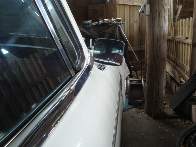

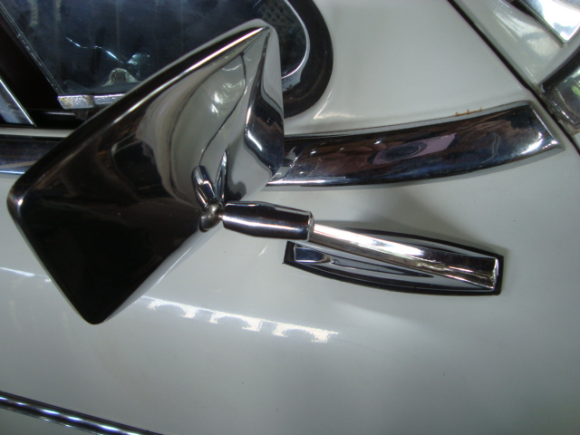

              Lastly some pics of the installation of the passenger's mirror process. I'm 1 1/2 feet taller than my daughter so I had her sit in the driver's seat with the seat adjusted and tell me the best location for the mirror. I also made sure that there was some adjustment left in the mirror after I got it where it needed to be. You also have to take the vent window into consideration:
ID:	1708776Click image for larger version
              I didn't have much time today because I had to help my nephew. He had a large tree fall on his roof and AC unit. It took a few hours to chop it up.
              Treblig
              • Well it was scary but easy:
                You have to make three holes actually. Two for the screws and one for the alignment button:
                you can see the alignment button here:
                Once you get the two screw hole in the correct location you can see where the hole for the "button" needs to be:
ID:	1708802Click image for larger version
ID:	1708801Click image for larger version
                On my mirror gasket (plastic) there was a thick side and a thin side and since the thick side was on top on the driver's side I did the same thing on the passenger's side. It is very important which side (up or down) you want the thick side because once you drill the hole for the button the plastic gasket will only go "on" one way:
ID:	1708799Click image for larger version
                After making the three holes you simply install the mirror and pat yourself on the back:
ID:	1708805Click image for larger version
ID:	1708804Click image for larger version
                I had time to replace the passenger's door striker and install the antennae. Tomorrow I'll start making the new rear view mirror shaft (the one that goes from the headliner to the mirror. I've ordered a slightly larger mirror from ebay and it will require a shaft (rod) that needs to be shaped a little differently than the original.

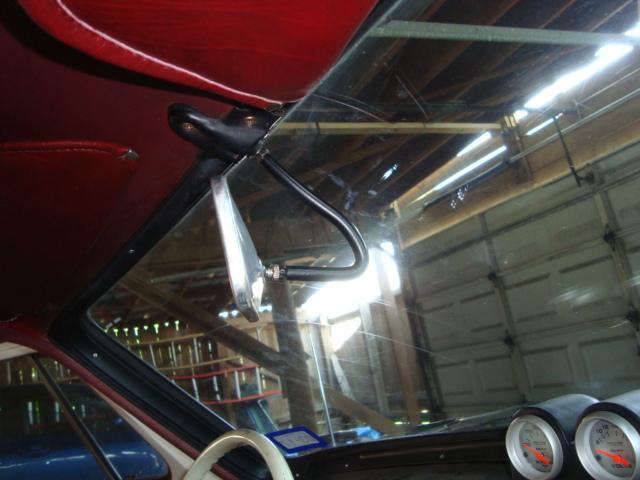

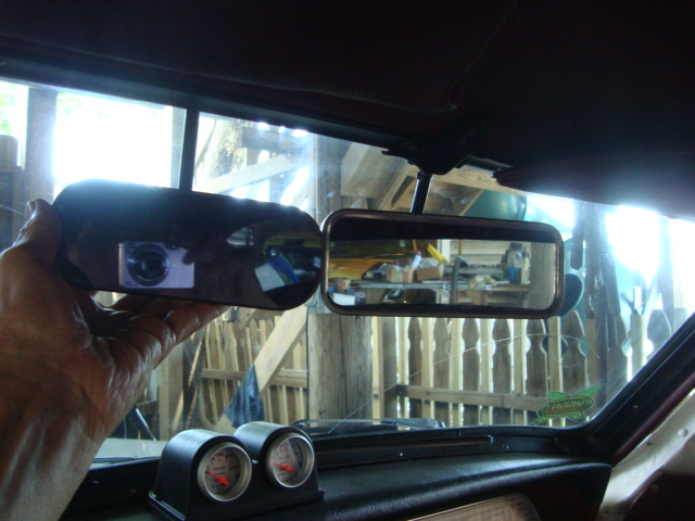

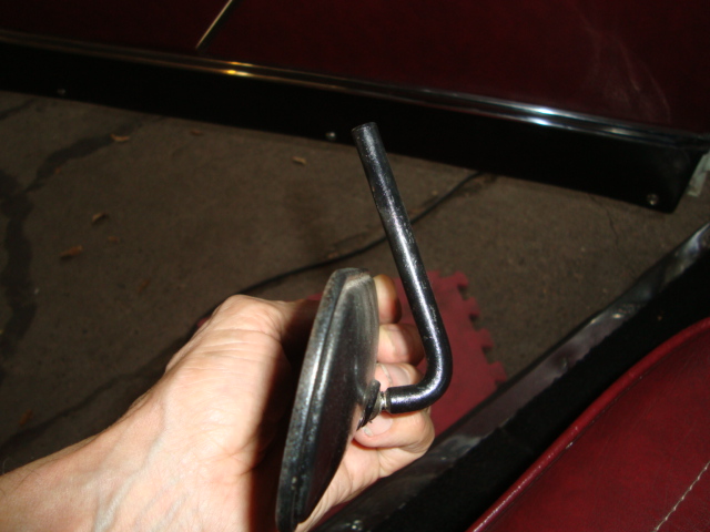

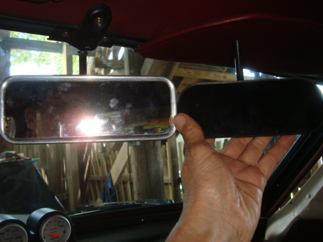

                • Got the new slightly larger mirror installed today. I had to manufacture a new rod (stand) for it. It required drilling a hole and tapping a 1/4 X 28 threads in the end of some 3/8" rod. Then put all the necessary bends to get the mirror in the correct spot with plenty of adjustment. After bending I drilled a 3/16" hole in the other end to install a shank of a 3/16" bolt/screw which was the size of the internally threaded ball on the new mirror. I forgot to take pics of the process but it turned out nice and my daughter likes it:
                  These first two pics show the comparison between the old and new mirror:
ID:	1708845Click image for larger version
                  Here a side view of the old rod (stand). Since the ball joint was made as part of the rod I couldn't use it because the new mirror already had the ball pressed into the back of the mirror frame:
                  The ball on the new mirror had a 3/16" internally threaded hole. So I got a 3/16" bolt and cut the head off. Then drilled a 3/16" hole in the lower end of the rod. I used my grinder to cut a slot in the side (exposing the 3/16" hole). I inserted the 3/16" bolt shank into the hole and welded it in there through the slot I had cut in the rod. then i filed it smooth, sanded it good and painted the rod.
ID:	1708846Click image for larger version
ID:	1708847Click image for larger version
                  I had my daughter sit in the car with the seat properly adjusted and located the exact position for the mirror so that it wouldn't interfere with the driver's view out the front of the car.
                  For an old timey mirror I found on ebay it turned out real nice!!
