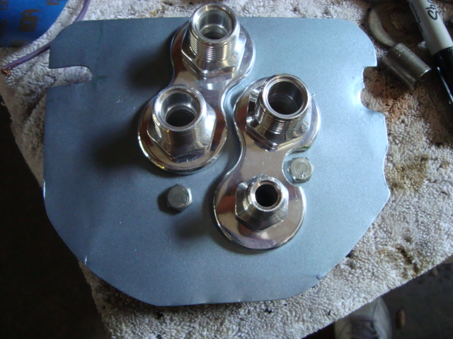

                      • Had to spend a day getting my son to surgery on his knee so I haven't been able to do much but I managed to get a plate trimmed to fit over the opening in the firewall where the AC lines used to run through. Since I now have a heater up under the passenger dash I had to cut a little more of the firewall for the heater lines. No big deal because I can simply make a plate to cover everything. I already received the bulkhead fittings so it was pretty easy:

                        Once I had the plate to cover the hole(s) in the firewall I drilled it for the bulkhead fittings:

                        So the big plate goes on the engine side of the firewall and the small plate goes on the inside of the firewall sandwiching the actual firewall in between the two plates. I also used existing bolts (first two pics) that were already on the firewall to hold the plate in place.
                        I'll weld the T-nuts on the inside plate so that I can install the outer plate with bolts (1/4" X 20). This will make it easy to attach the heater hoses and the AC lines and remove the plate (when necessary) that holds the fittings.

                        • Had time to finish the bulkhead fitting panel. I welded the T-nuts to the inside plate so I could suck the two plates together sandwiching the firewall in between. With the T-nuts on there I'll be able to disconnect (when necessary) the AC and heater lines and remove the fittings but the plate will stay attached to the firewall. I also put a bead of dum dum along the inside edge of the outer plate to seal the plate to the firewall.:
