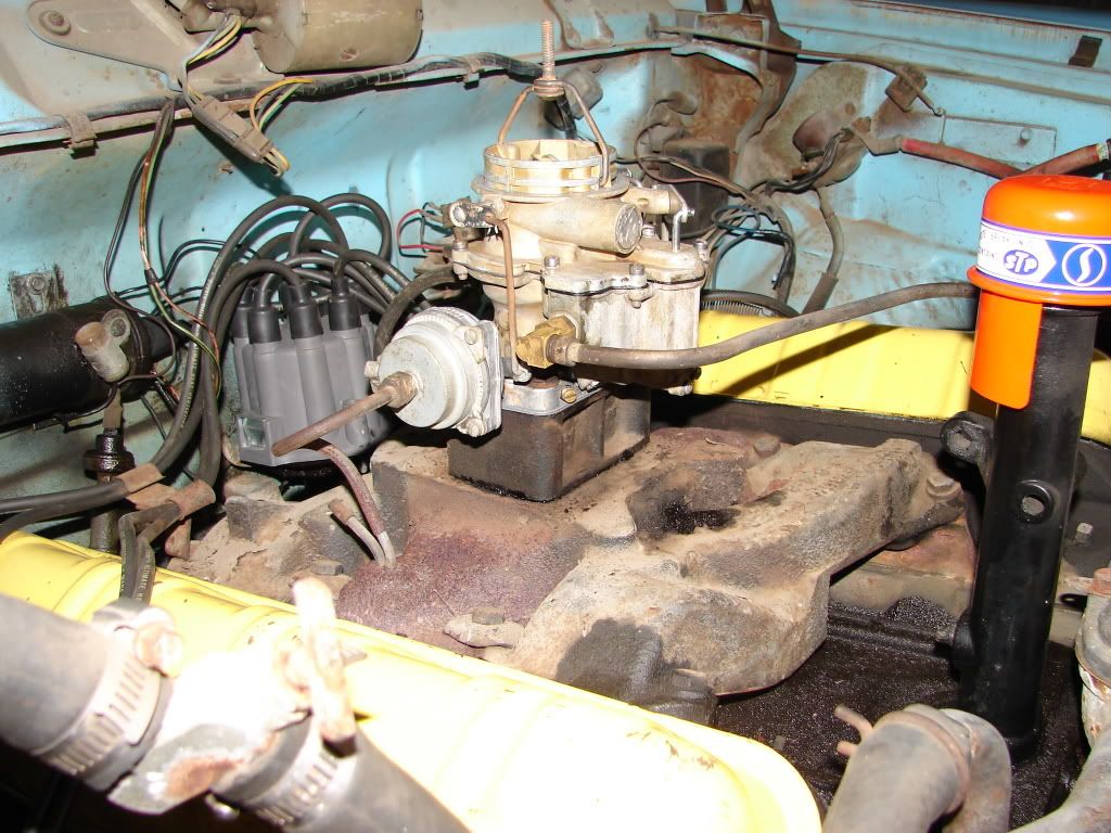

                  Don't have any extra myself, but it will look like this: (ignore the spacer between the carb and the intake - truck application but does not change the carburetor). Good luck
                    Actually it does not look quite like that, that is a 6-130 or 6-132 used on '63-'64 Cars with the Low Choke and Flat Air Cleaner Mounting and the Stud in the center instead of the Clamp on, beveled mouth correct type for a '61 or '62. It is similar and with modifying the Choke Heater Tube, getting a '63-'64 Air cleaner and possibly adding a PCV Valve, it could work.

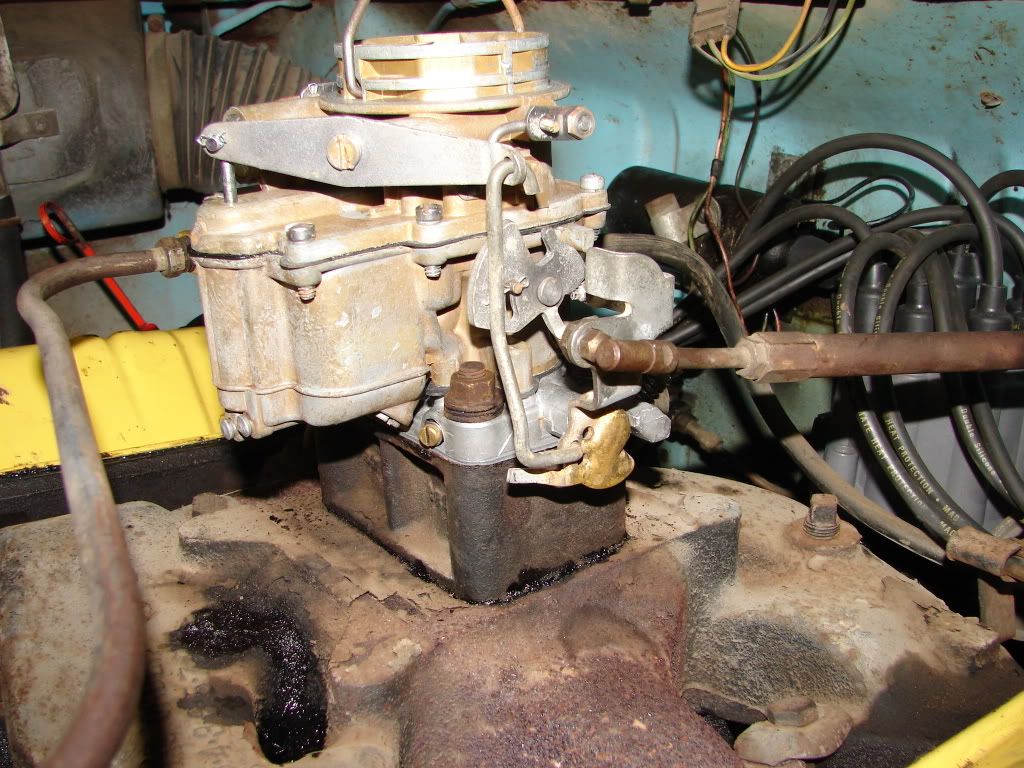

                      Actually, Rich; I beg to differ on the air cleaner mounting provision. Here is the 6-127 carburetor I offered Mike from my stock via PM.
                      As you can see, it is clearly stamped 6-127 and has the "straight" air horn style for a non-clamp air cleaner:
                      it couldn't be a mismatch of parts because the air horn with air cleaner provision is part of the casting on which 6-127 is stamped:
                      (Of course, it is the LIMITED model....I was having a little fun with an emblem on my work bench.) BP
                        And I tend to forget that the motor in my truck is out of a '63 Cruiser - marked C-132 - so sorry for any confusion.
                          at any time (and I've done it a few times) someone could have easily placed the top of a 127 on a 132 without much thought (flatter surface for sealing, throttle shaft improvement). I would tend to find a 132 and the readily available air cleaners myself....Then again, there is the question of PCV arrangement....
                            'Not sure what the confusion is here; the 127 has the "readily-available air cleaner arrangement," per the photos I posted.
                            As I said, the 6-127 is stamped on the same casting as the air cleaner provision, so that can't be changed by changing the bowl cover unless you were to grind off the ID stamping and restamp it, which would be kind of ridiculous. (We aren't talking about Corvettes, here, you know....) BP
