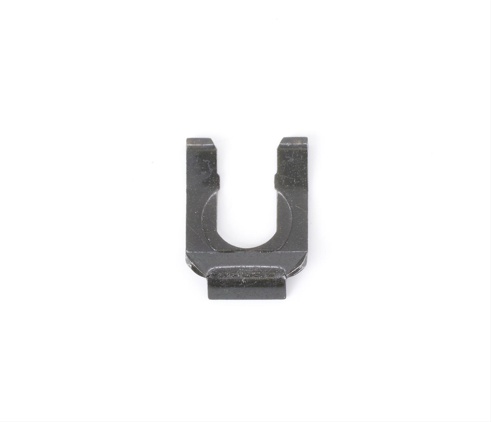

    Anyone have a couple of these e-brake cable clip to bracket. Part number 533290. Used on cars from 53 to 64 at least. SI says they don't have them. I find no discussion of them on the forum. Is there an interchange?
    I have this one that may be usable but after cleaning with Evapo-rust, it is pretty thin and brittle.
    Cliff
    54 Commander Coupe driver
    53 Commander Hardtop project
    SE Washington State
    cliff, that looks like the clip that holds the rubber brake hose in the bracket on the frame, 2 front 1 rear.i'd go to a local junk yard. Doofus
      They are not the same as the brake hose clip, they are smaller, they are thin to begin with, they are sort of concave. I would try Tom Karkiewicz

        Cliff when i built my 53 i used "E" clips from hardware store. groove dia.437,groove width.147. Good Luck, Doofus

            Fred, have you used the PBK-01 clip from inlinetube? It is hard to tell from the picture if it is close enough to the same size. I've got tomorrow afternoon off from work (getting a tooth pulled) so maybe I'll call them and order a few.

              I used to stock those very clips when I was in the garage business. I checked and still have two left which I will keep for my own use but they should work for you. I believe I used two of those on my 56 Champion which I just finished up lat winter.
              Nick
                Thanks to karterfred88 and njonkman for the info. I didn't have anything else I needed to order from inlinetube but I noticed that the Right Stuff Detailing EDH1007 clip looked like the same clip as the ones at inlinetube and was available at Summit Racing, Jegs, etc. Since I was placing an order with Summit anyway, I ordered a few of them. I would like to report that they fit perfectly and seem to be more secure than the stock clips.
