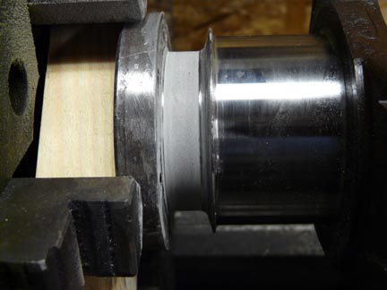

                        I also used JB Weld to repair my 56 Champion crankshaft. There were a number of pits in the rear seal journal which a crank grinder could not get at and the seal had leaked so bad that the whole bottom of the car was oiled. So I put the crank in my large metal lathe and skimmed a bit of the journal. Cleaned it real good with lacquer thinners and applied JB Weld. Then I tried machining it down to speck. I found as I was getting down to speck I was peeling it off. So ended up machining the journal down about 1/32 inch under size and that worked. It machined down fine and polished up beautifully. We ran it all this past summer and not a drop of oil. The JB Weld will not pit from moister as the steel would so feel very confident in it as the best way to repair that problem.
