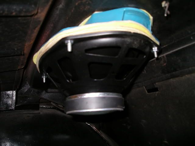

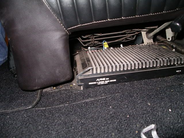

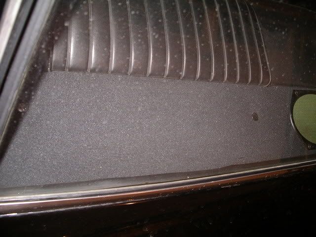

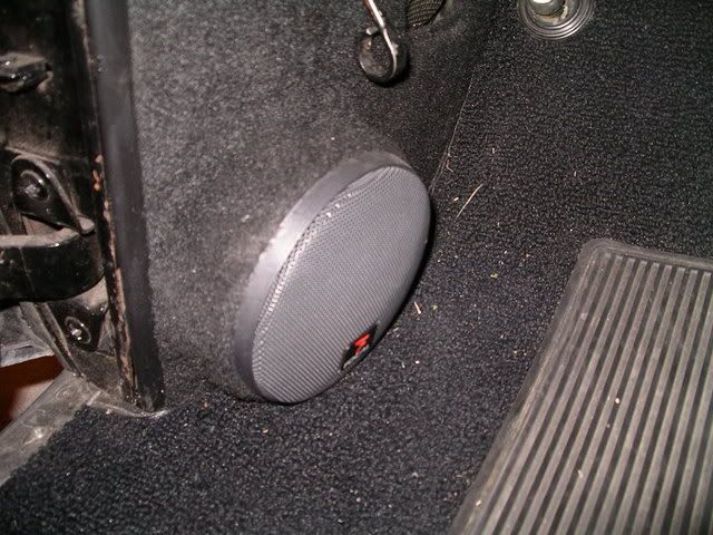

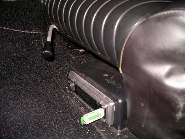

          Here are the pictures of my stereo install, excuse the mess on the carpet I drive this car every day.
          Rear speaker with 3"x7" to 6"x9" convertor
          Invisible rear deck speaker under speaker cloth
          Front 4" speaker pod
          CD Player with MP3 memory stick
          Old alpine amp
