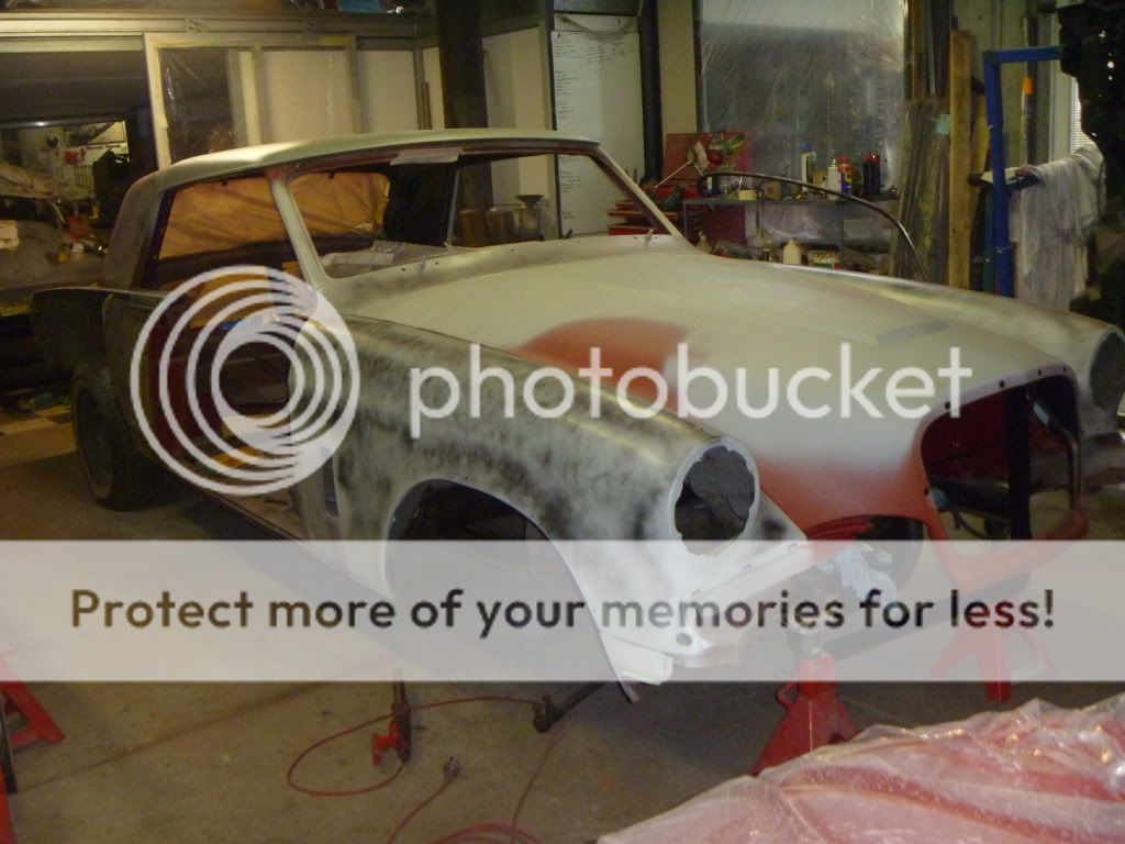

        I just finsihed my '64 Daytona in this color; I went to my jobber, who sells Sherwin Williams, and they found it under "4th dimension" brand B/C, and they had it listed P-6418 as SN-60 said. The brand is a cheaper brand, but it looks great!
        Here is pic before final assembly of trim:

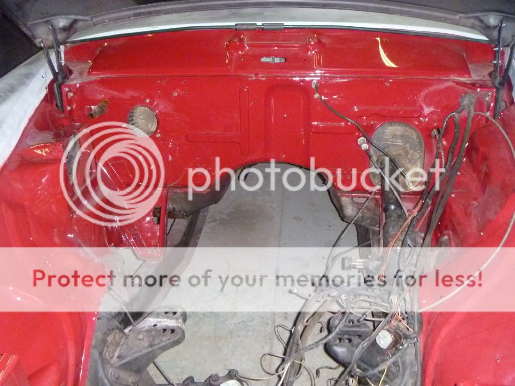

            I have just done this engine bay in Bordeax Red ona factory 64 GT, the car has original paint and the bay has never been painted. In preparing it I took off the battery decal on the L/H skirt which revealed a perfect colour match of the colour. The colour I used is a Renault colour which can you believe is called Bordeux, In 2 stage paint,
            PPG code LO11 it's a perfect match!

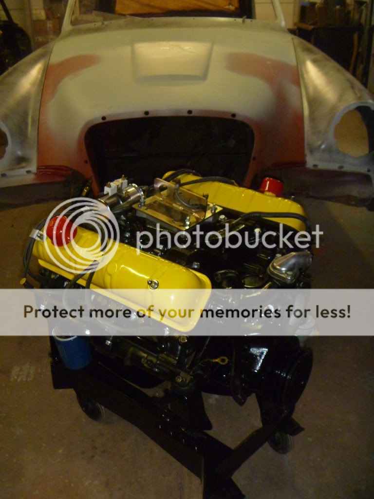

                    Steve,here are some more pics of the 64 since you have the same car, all options, powershift, P/S, power discs, except aircon, just rebuilt the original engine with R3 valves, double valve springs, ported and matched heads, R2 cam and running an Edelbrock 500 carby, should go good in the midrange powerband.
                    Forgot to mention that Renault colour is a 1980-82 vintage, just in case you have trouble finding it.
                    Brian
