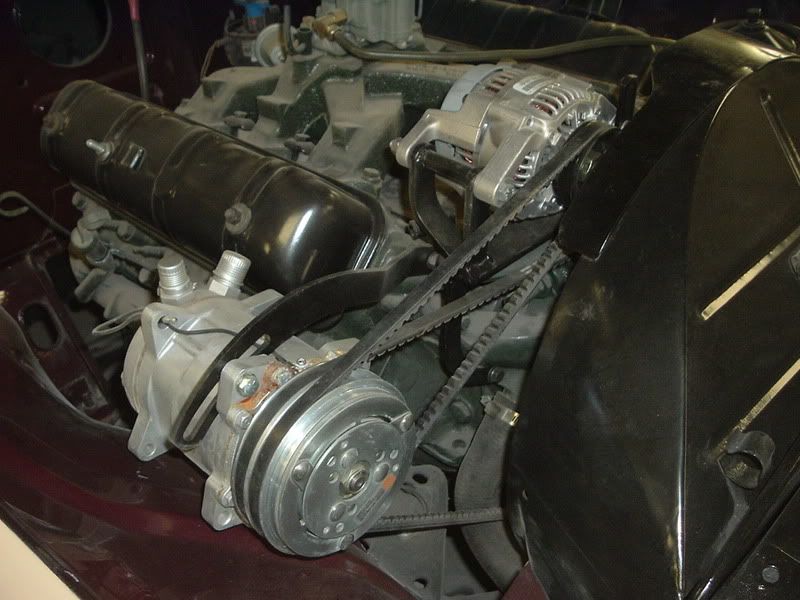

          Converted to 12-volt and adapted the generator bracket to hold a Sanden 508 per his instructions. Fit an alternator (Worldwide # 14824) to fabricated bracket. Other than the evaporator my A/C parts are from Vintage Air.
          And found an Artic Kar evaporator that looks correct for the period; the Mark IV would probably be a better choice for serviceability.

            Nice bracketry on the engine for the compressor and the alternator.
