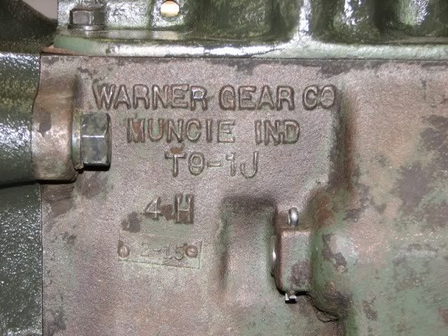

            Transmission ID
            This is the left side of my T9.

              Just looked at the T-98 and the cast number is in the same place as Ricks T-9. Drivers side of the trans right behind the top trans to bellhousing bolt. Steve
                Thanks all. Now I know. Just pull the floorboard cover and there the ID is. However, StudeRich made an interesting aside, saying he had installed a New Process 5 OD transmission. That would be really neat if one would fit my 2R10 with Champion engine. Both synchro AND freeway-sensible engine revs. So my question to StudeRich is whether I should consider one. I live in Tacoma WA, so could easily come up to see his truck and talk. What about it? Best, Phil B. <philbirkeland@gmail.com> 253.564.9109 (h) or 253.279.9724 (c).
