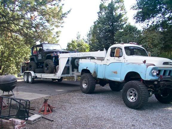

I don't know about specs but here's what I have proven. NOTE: I wouldn't try these things. I mentioned the other day our '58 1/2 ton with a stock 289 and 4 spd. The hitch was the optional barden bumper that was fastened to the frame by four 3/4 inch bolts. We towed 10,000 lbs behind it. Then years later with some mods to the truck: turbocharged 289, 5psd, 3/4 ton, we towed 12,000 lbs behind it. Plus you need to figure the weight of the truck that the engine has to move, which for me is 5,000 lbs. You need to first consider what you plan on towing, ie: what kind of trailer and what you plan on hauling on it. Here is one picture of our truck and trailer with the Jeep that we usually haul. That total load is about 9,000 lbs.
Jake

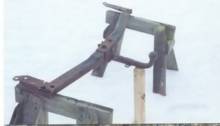

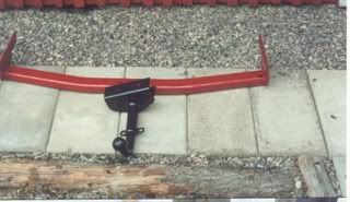

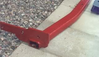

Hello all.
Thanks for your inputs.
New cars have the limit in the registration paper, no problem there.
And you have to use a factoty or factory aftermarket hich, stampet with its tow limit.
If you want a hich for your old car, You can make it by your self,
I done that for a GT Hawk and a Provincial.
I used a Volvo 740 hich for the Provincial
and some Mazda hich for the GT.
They was bolted to the frame and I got them legal for 1500 kilos (3300 pounds ) This is the max weight you can get legal for home made hiches.
And it was enought for these cars.
I used them for my camper.
I think it will be good for the Champ pickup to.
It has the small 6 cyl engine and 3 speed.
In future my plane was a bigger truck (Studebaker) with a slide in camper and a Studebaker hehind it on a trailer.
But the Swedish rules seems to make this inpossible,
because of no factory tow limits.
Thanks.
Lennart...

This is the hich for the Provincial made from Volvo 740
Lennart...
