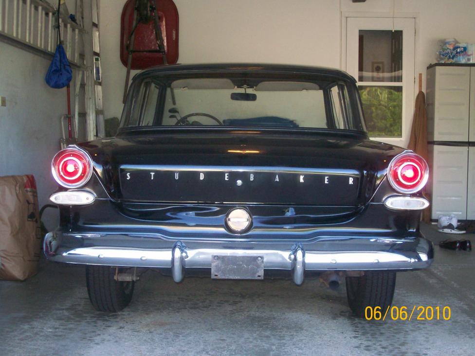

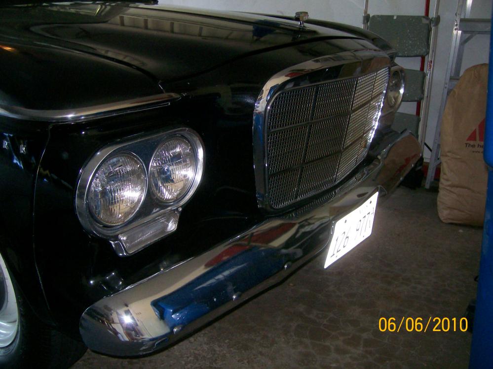

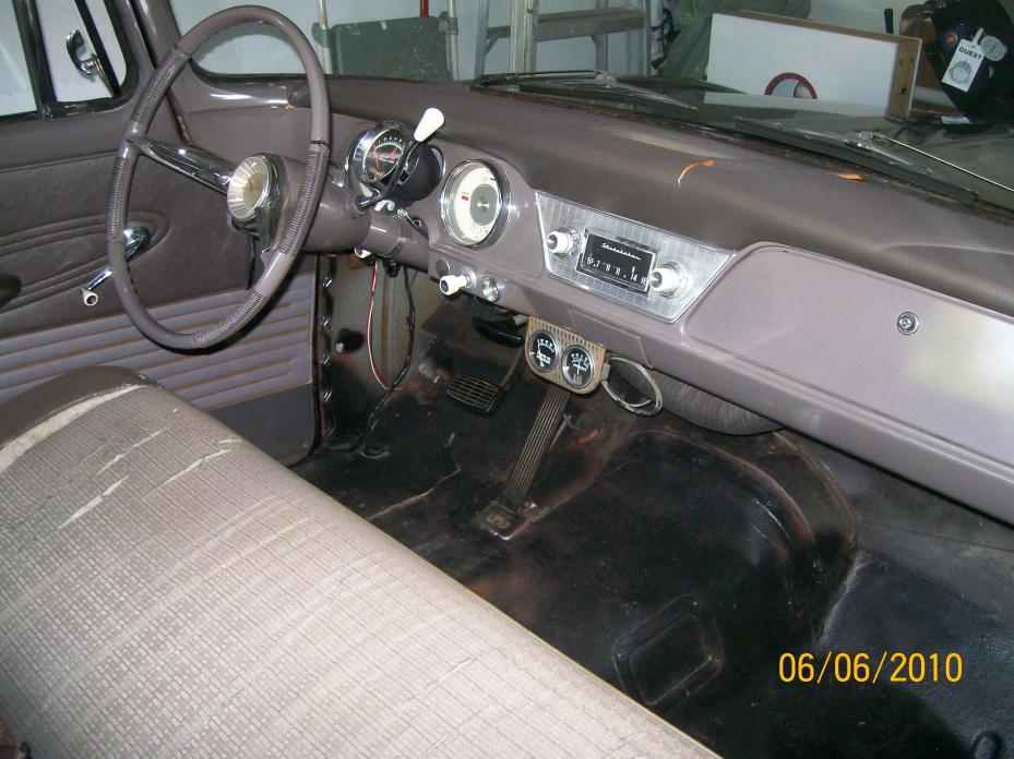

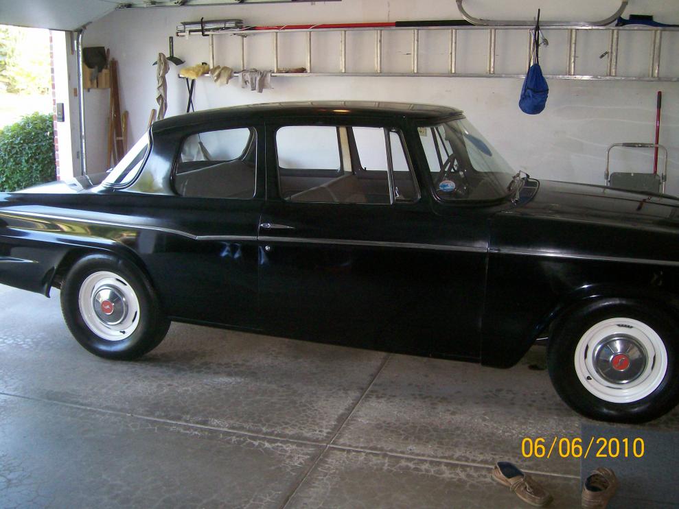

That Lark is so clean I would just keep it and drive it that way and pick up another to do the transplant in. You can never have enough Studebakers.If you car is ugly then it better be fast.....

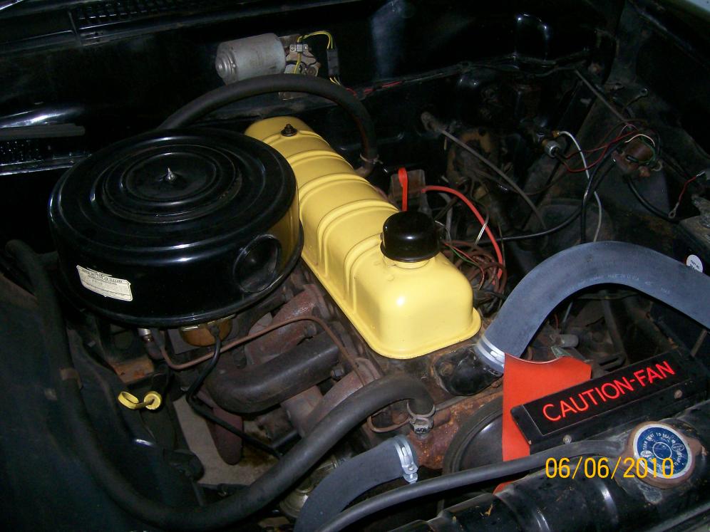

Pinkie had the same engine and trans but her block was frozen and someone had painted her with pink house paint and the front and back glass was broken and the upholstery and head liner were gone.If you car is ugly then it better be fast.....
