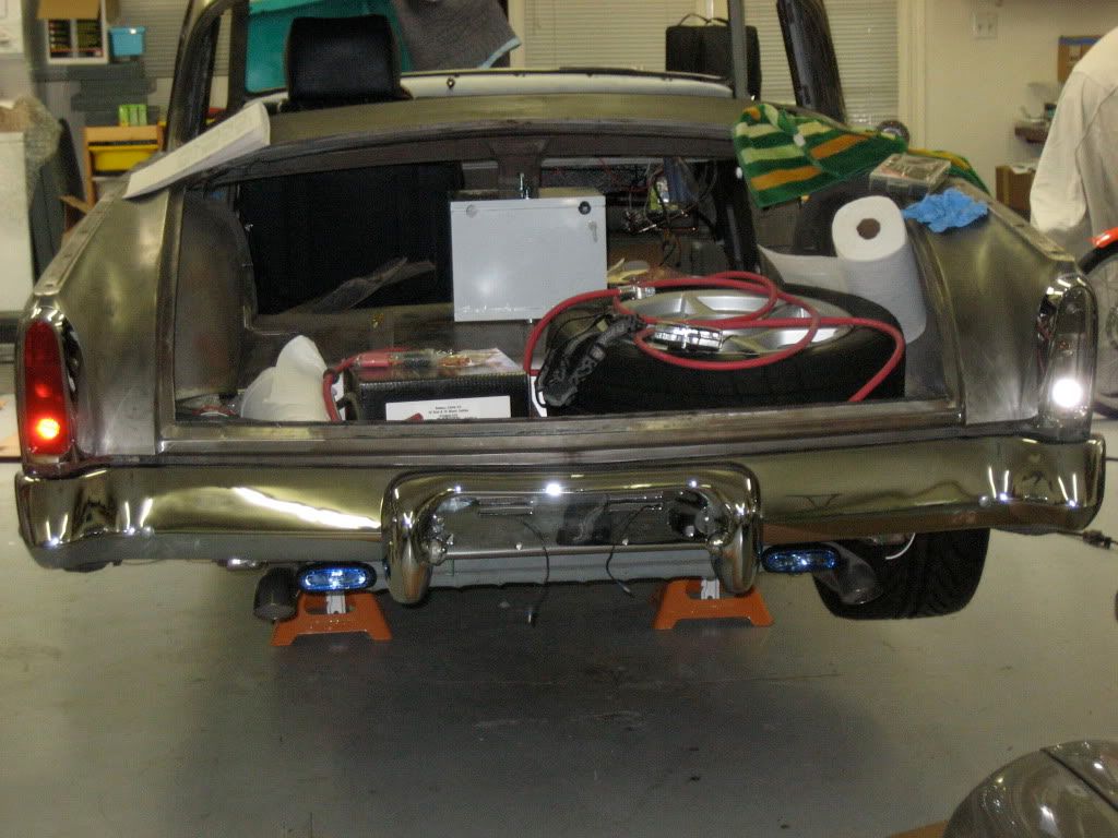

                      Clearance in that location is tight, as you might expect. But here's what it looks like anyway.
                      I made a little spacer to take up the distance between the bottom of the battery box and the indentation in the trunk floor.

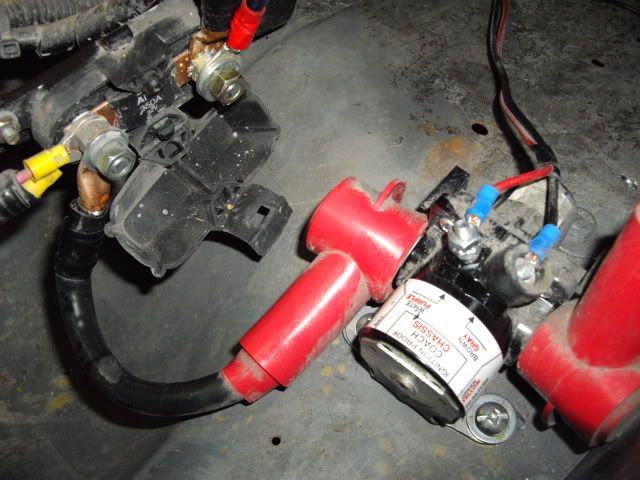

                            This is my fusible link/remote shutoff setup in the 54K.
                            I ran my trunk mounted battery cable under the car along the passenger side hog trough. I ran a piece of PVC Conduit along the route and then pushed the cable through it. The conduit runs from the trunk floor above the rear axle to just short of the SBC starter. I did it to be sure the cable is not hit by something I didn't plan for.
                            The remote shutoff came from a trailer supply house and has both an On and Off terminal, and draws no current to keep in position so it only requires a momentary three position switch.
