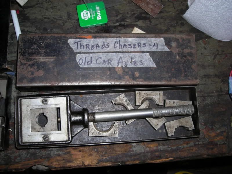

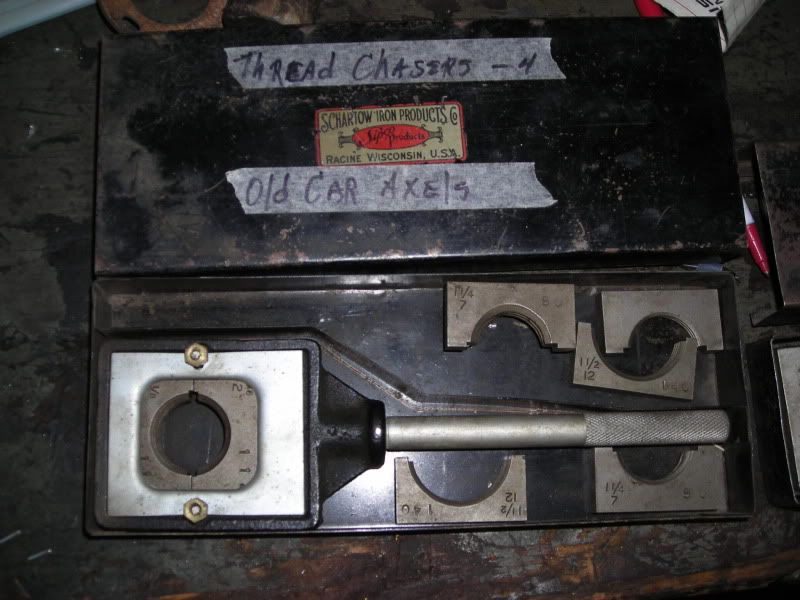

            I bought these at an old tool sale last weekend. I think this is what you need.

              this is more like what I have
              it doesn't care what the diameter of the part is that you're chasing the threads of, only the thread form and pitch.

                  I have a thread chaser like in Nate's link. Not sure the one I have will work on something as small as an axle end.(maybe). I use those on full-floater axle tube ends where bearing nuts go. The thread chaser Ann pictures looks like the thing to use if it has the right size dies in it if threads are damaged to the point a hex is difficult to start. Those can be install behind damaged threads and worked outward to damaged part of thread.
