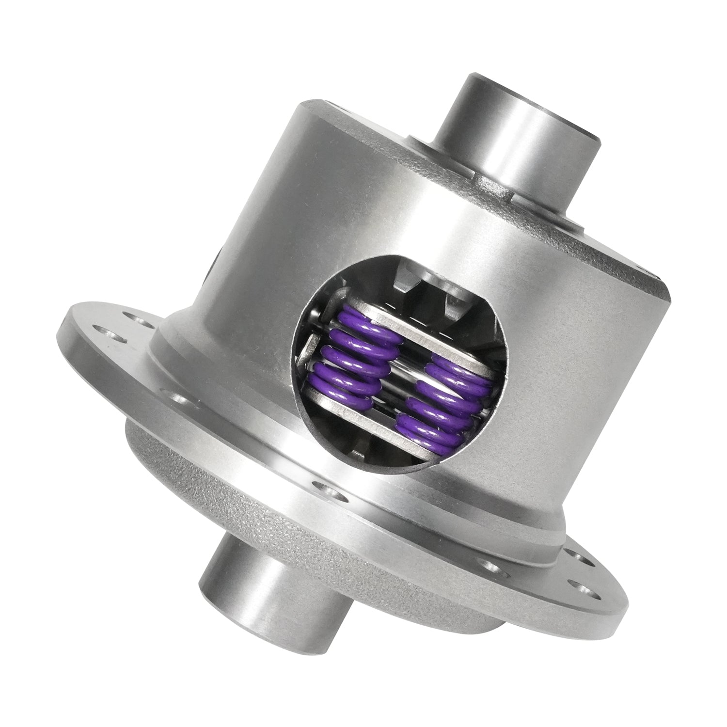

        This is a much more expensive option only for a Dana 44, but you would have to check with Randy's Ring and Pinion on the details and fit for a Studebaker, AND get a complete Model 44 Diff. with a worn out TT or a good "Open" Model 44 to convert to a Yukon Gear Limited Slip.
        Quite expensive, but really Good is not cheap, at least it would be all new and guaranteed.
        You would need the 19 Spline version, here is an example:
        Dana 44 3.73 & Down Yukon Dura Grip Limited Slip, 30 Spline, Will Fit Applications with Independent Front Suspension with YSPSPR-001 Spring Kit

          Here you go. You don't even need to change the ring gear carrier.
