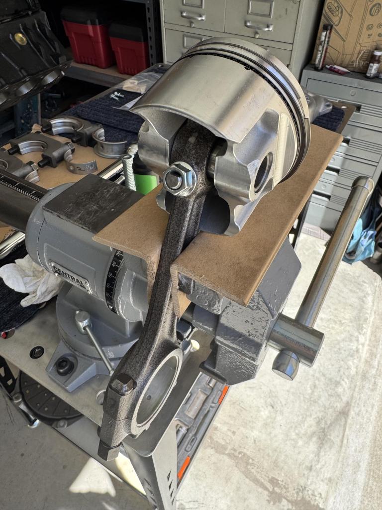

            Done fixing the pinch bolts. Swapped the ones around that had the nuts on the wrong side to the correct side. Ditched the black nuts and decided to go with a serrated flanged standard steel nut. Brand new set of pinch bolts. Put a little blue Loctite on the threads. Tapped, torqued and repeated all several times to 28ft-lbs. as per the manual. Seems to be no orientation on the pistons, so left those as were.
            From this, wrong:
            Click image for larger version  Name:	IMG_1884.jpg Views:	0 Size:	77.6 KB ID:	2067277
            to this, for better or worse, at least the nut is on the correct side of the rod. And I know for sure it is at the proper 28ft-lbs.
            Click image for larger version  Name:	IMG_1885.jpg Views:	0 Size:	125.4 KB ID:	2067278

              Make sure the oil squirt hole in the bearing lines up with the hole in the rod.
              Bez Auto Alchemy
              573-318-8948
              http://bezautoalchemy.com
              • M-Webb
                M-Webb commented
                Editing a comment
                Thanks for the tip. Yes, they do. I also ran a little wire through them to make sure they are clear, not clogged up.
