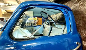

        My last experience installing a new EPAS system was on a Transtar pickup.
        In my opinion, this was the perfect application of an EPAS.
        No crazy modifications to the beam axle, reach rods, or steering box were required (other than shortening the seeing column shaft).
        Many happy miles driven several years after the install.
        That install was not for the timid or inexperienced. It was done with the engine out, which made steering gear/colum access easier.
        Mounting the EPAS unit was not a simple bolt in. The torque support strap placement was tricky inside the cab under the dash.
        I liked the EPAS experience. But it was not 'simple' and if one has to pay for the installation, then the actual costs need to be discussed and agreed to well ahead of time.
