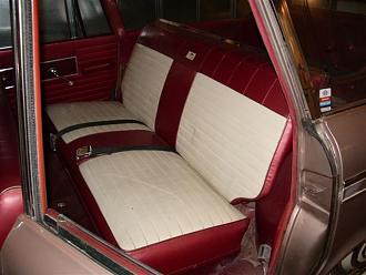

    Below are Daytona trim Seats:
Name:	Steinkamp Wagonaire2.jpg
Name:	Rose Mist 63 Daytona7.jpg
    This Maroon Daytona Interior is correct for a '63 with the Gold Lark "Bird" on the rear seat back.
    The Blue one has '64 Seats.
