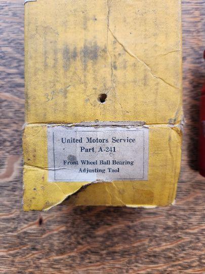

                  Picked up this Wheel Bearing Adjustment tool years ago and have never used it. Looks like a mini-torque wrench (beam type).
