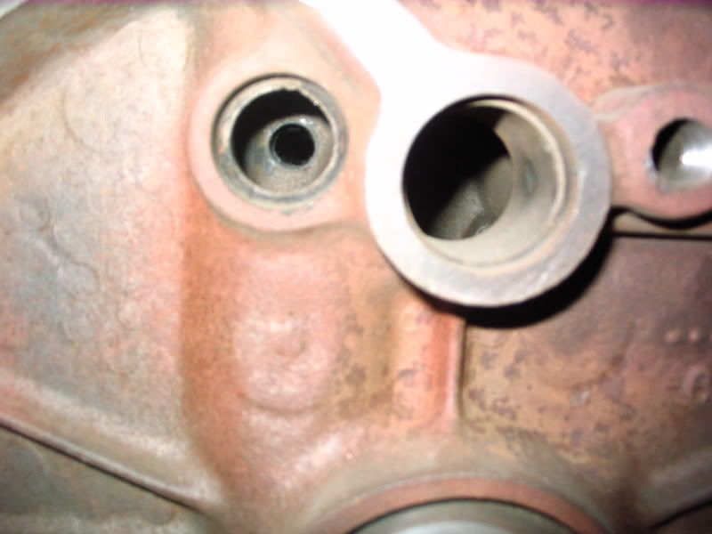

    Looking at the back of the engine, it is on the left side of the cam about 1 1/2" inches behind the 1.25" freeze plug. Looking down the dist. hole it is on the drivers side. It is a 1/4" taper pipe plug.

          From the rear.
          Down the dist. hole.
            Thanks to all the responses, I was able to locate the plug, in place!
