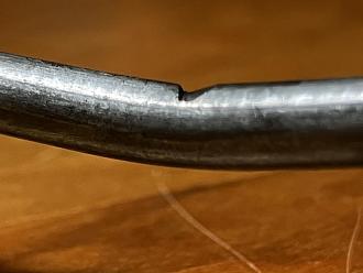

                Much frustration, exasperation has yielded to exhilaration over finally installing the dual m/c (Napa/Raybestos MC 36237) in my 62 GT with drum/drum brakes.
                BIG THANKS to “Topper2011” for letting me crawl around under his to figure it out (moving fuel line further left). A couple slight tweaks to the kit made all the difference.
                All new lines/hydraulics/DOT5 meant everything came out. Alarm at the Click image for larger version
ID:	2034921 condition of the old front crossover line (pictured).
                Had I not committed to DOT 5 change, I might not have cleaned and inspected this closely enough! Now I carefully inspect every component I encounter anywhere on the car.
                Lesson learned!
