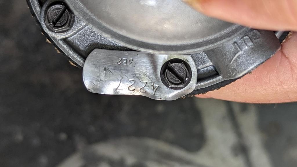

      I have a Carter 4227 pump in my 1964 259 V-8 too and after we installed the gaskets and rebuild kit I have oil oozing out the small hole at the top. Not finding any parts for it I bought a Carter M2211 (China made) on ebay. That failed immediately so Im back to the 4227 in my pictures attached. Can I just thread that hole and put a screw in it to stop the oil oozing out? Studebaker International sells a pump thats really expensive, around $200 is that the only choice?

        If you have a genuine 4227 pump, that number is stamped on the flange of the pump and I have one in my hands as I type this note along with an old repair kit for it supplied by Dave Thibeault way befor the "China" era. The kit is marked as "Fpa 230."

        Sorry to tell you, but ALL of those are Airtex, they are "Sold BY" many names; Master, Carter, NAPA, Carquest, Advance, O'Reilly you name it.
        Please don't unintentionally muddy the REAL Carter Good Name.
        A '55 to '62 Carter Original OEM Fuel Pump, they came in Metal Filter Bowl type ('63-'64), and Glass as shown, they Both have built-in Filters:

        NO, do NOT plug the Vent hole, it will not work and destroy itself.
          StudeRich has told be that if you have a pump that has the arm that's riveted it's one of the Chinese copies, aka junk, so don't bother with it. Get a good one from one of our vendors & you'll be $$$ ahead!

            Update: Not all V8 Fuel Pumps with the several Plates riveted together are exactly complete Offshore junk.
            It is the AC and Airtex Pumps that used that type of actuator Lever, but there were hundreds, maybe thousands made in the USA by AC (GM) for aftermarket replacements for the Factory, OEM Carter Pumps back in the Day, that worked OK and CAN be rebuilt.
            Then, more recently Airtex started Coping these AC Pumps and selling them to Auto Parts Store Chains because in the 1970's & 80's there was a Fair demand.
            So it is THESE made since about 2022 by Airtex and sold by many well known Names like Carter that are Junk, Now, it is WAY beyond Leaking Oil, making Noise and a short life, they actually do NOT Pump at all, now in the 2023 version that I believe has been discontinued.
