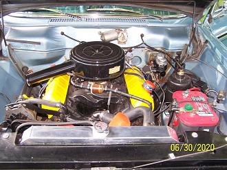

      Below is a '66 Cruiser, the Hot Coolant Engine connection barely visible coming from the Intake Coolant crossover forward and down under the Alternator.
      Left Click this 3 Times to enlarge it.
      Click image for larger version  Name:	66 Maroon Cruiser5.jpg Views:	0 Size:	145.3 KB ID:	1976520
      Yes it has the wrong Color (Early '65) Valve Covers and Air Cleaner Lid, but it Does look better than Black.
