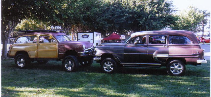

    Usually the rear bar is smaller. (talking soild bars here) I've used Lincoln MK 4 rear bars on many vehicles If I remember correctly theyre 5/8" or 11/16" diameter. Both my '54 Chevy Wagon and '73 F100 have MK4 bars in the rear and 1980's BIG Ford station wagon 1 1/8" bars in front both handle surprisingly well. The F100 is lowered 4" and the Wagon is raised 11".
    This is the F110 before it was painted : My wagon is the one on the right, the Ford wagon is Jesse James's, you might remember it from Monster Garage.
