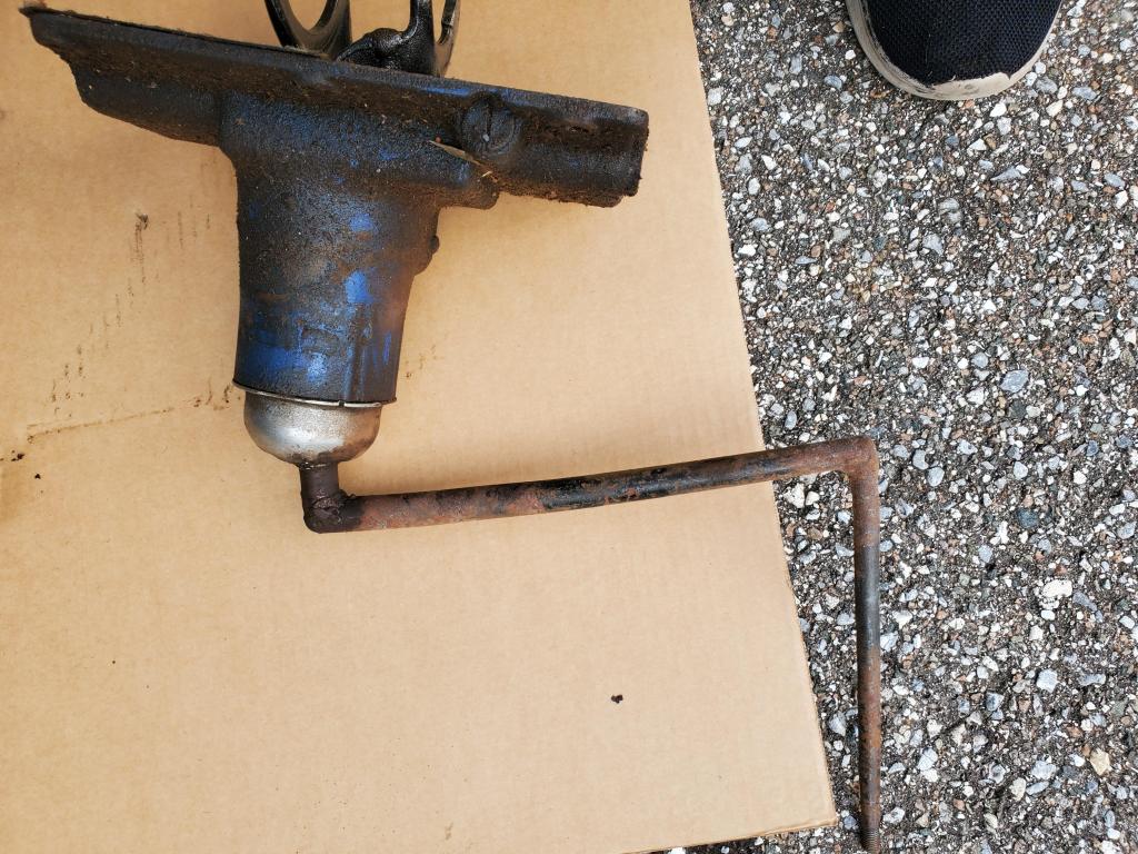

        If interested, I have a floor shifter that mounts to the top of trans. May work for you. Click image for larger version
ID:	1937406 Click image for larger version

            That is a T96 transmission. The same shifter ought to work on the T86, since all the mounting brackets attach to the R10 overdrive case, which is common to both transmissions. Linkage rods would need to be slightly longer, I think, by some fractions of an inch. Those linkage rods look a little spindly.

                  You are talking about the same thing as offered in Post #4, but apparently the OP wants a Conversion Kit, (Side Shifter) not a Top Shifter.
