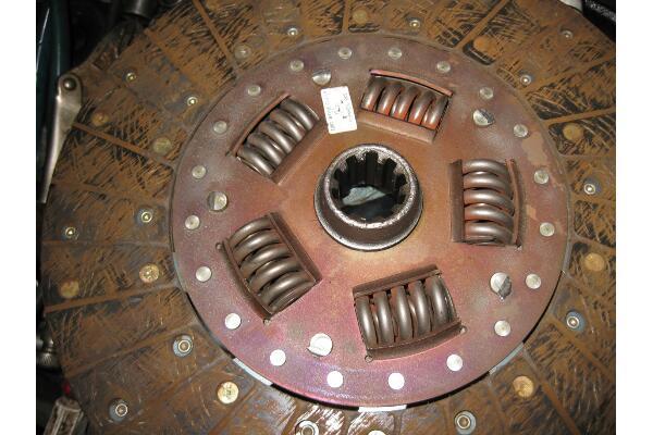

    Just as a matter of information. The PO of my 5E7 Champ replaced the 11" clutch when he rebuilt the engine. I found some rivets were rubbing on the flywheel and had some one fix the problem on a lathe. I don't know where the parts came from.

      What rivets were those, the ones in the Hub? Are you sure the Disc was installed with the "Flywheel Side" to the Flywheel?
