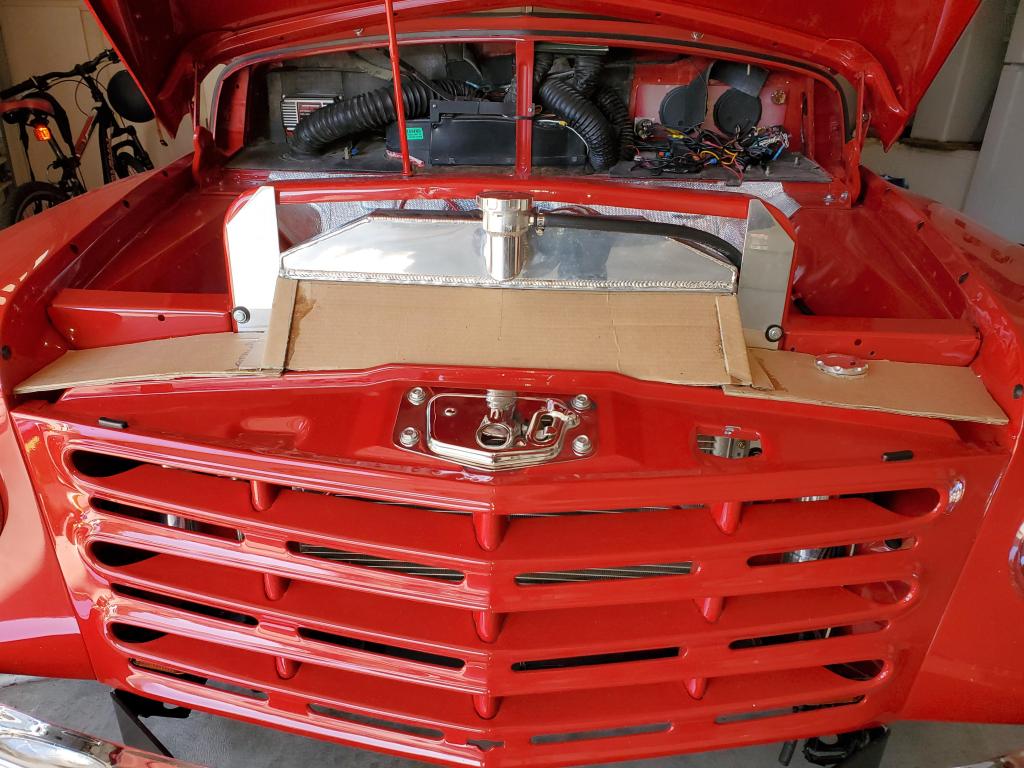

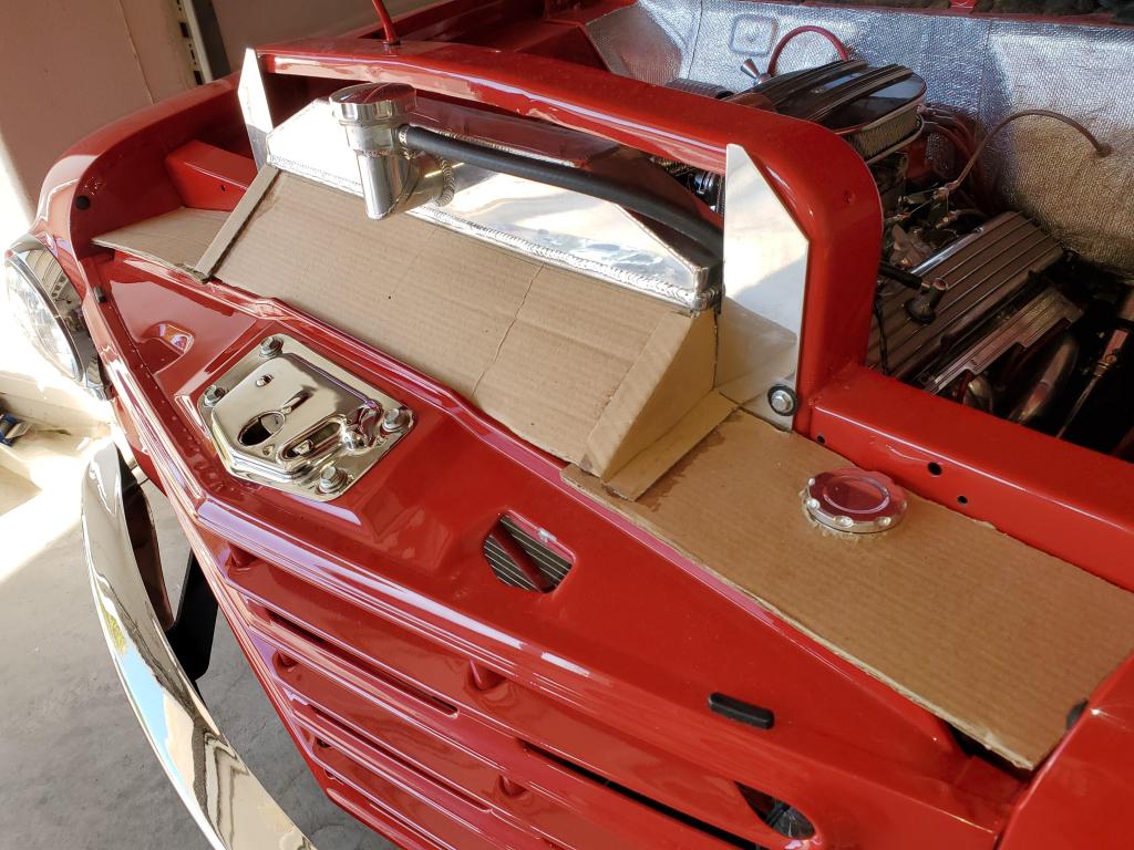

          OK on to the next step in sorting out my overheating problem. I made a cardboard "shroud" prototype to block heat coming over the top of, and into the front of, the radiator. It probably closes off 98% of the area where hot air could get in. It is held together with high temperature adhesive. Not pretty but it will serve the purpose. Next I will take it for a drive to heat the engine up, and then stop with the engine running (and the hood down) and see if it overheats as before. If this is successful I'll have a nicer shroud made of polished aluminum. Click image for larger version  Name:	20201122_135410.jpg Views:	0 Size:	86.6 KB ID:	1866506Click image for larger version  Name:	20201122_135353.jpg Views:	0 Size:	104.7 KB ID:	1866503Click image for larger version  Name:	20201122_135430.jpg Views:	0 Size:	131.0 KB ID:	1866504Click image for larger version  Name:	20201122_135315.jpg Views:	0 Size:	125.0 KB ID:	1866505
