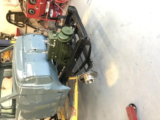

                Thanks to Ed Jones and Jim Sinclair for suggesting that Jason Brinkman may have the parts needed - and he did. I picked up the parts yesterday and Ed and I put the engine in today.
                  And I might add , This was a bolt in , There was no converting the the new block to bolt it in the Old M , See post #2 , Ed
                    Glad it all worked out for you Rowan. Jason is a super nice fellow. By the way, how did you get that engine to stay put with the truck on its side?
                    And, your painter did an awesome job!
                    Jim
                      I’ll figure out why my pictures end up on their side one of these days. Jason is a real nice guy and saved a bunch of money and time - thanks for the referral. The painter did a great job, there is nothing our friend Ed Jones can’t do exceptionally well -
