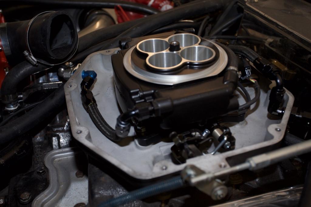

ID:	1728147The "best" carburetor, isn't even a carburetor. Fuel injection takes all the guess work out of the equation.
                        A wonderful solution if you have the $$$ and can set it up. For most of us a carb swap using the other parts as is is much more practical.
