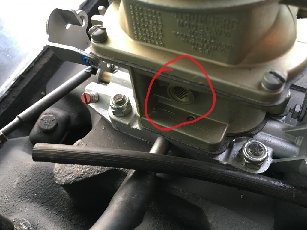

          Never seen a large threaded hole anywhere on a Stromberg. they were also used on GMC V6 trucks and lots of other vehicles. can you better describe exactly where the hole is? i have a couple in the shed but none like you describe. Face it those Bodges you complain about are keeping you active and going strong! Rain stopped, time to hit the 60 a lick, i'll look at the Stromberg just in case. Luck Doofus

            Hopefully this link will work. You can see the threaded hole on the centre of the carb body.

              OK mis understanding at this end. that is the vacuum port for the "Spark Modifier" nipple. Keep at it and i'll do the same. Luck Doofus

                What on earth is one of those and where do I connect it? I should have bought an Austin or an MG. I know what to do with those.

                  That is the vacuum line that will run to the vacuum advance on the distributor Photo below is from the factory. Large hose is PCV - small one loops to distributor.
                    Aaah, advance / retard vacuum pipe. Excellent thanks. We Brits have weird names for things

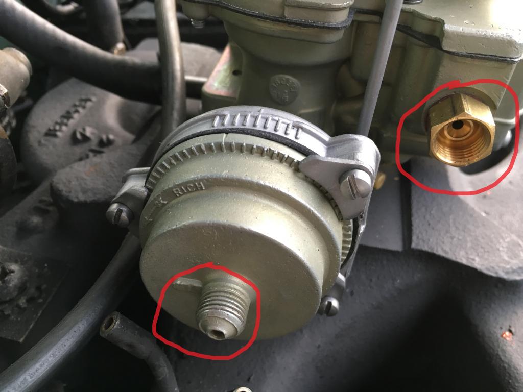

                          Thanks Skip. I've overcome the issue and it's all sorted.
                          Doofus, you messaged me to ask about fittings.....I need the three fittings to connect to these.
                          Top picture, fuel and heat loop to choke.
                          Bottom picture, vacuum to distributor/
