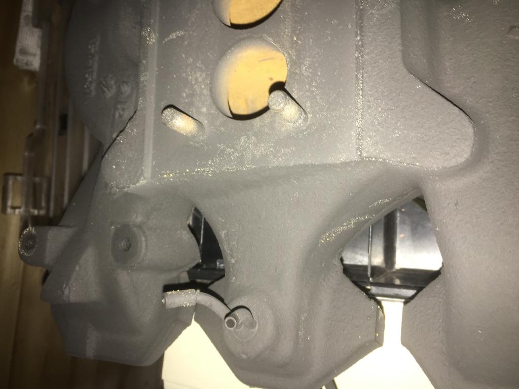

                  When I removed the Holley there were two pipes coming off the manifold on the left (left side as you look from the front of the car). I can see on my 2 barrel where one of the pipes go, but can't suss out where the other goes. Both pipes went to the Holley but the Stromberg only has one fitting. Does this make sense to anyone or am I being my usual dumb self?
                  *edit. Meant to say, some err....mechanic??? decided the 4 barel was way too much and "modified" it to run on just half the carb. The second chokes were disconnected and remained closed at all times.

                    Some Carbs. have a hose nipple near the Air Opening for a Hose to the Choke Heater Pipe to improve heat flow by adding suction. Other than the Heat Tube into the Exhaust center port of the Intake Manifold that should be the ONLY other "Pipe" used.

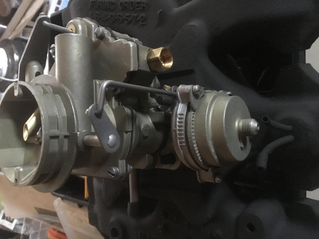

                      A photo may explain a little better. I know one of the pipes from the manifold I'll have to fit a tail connector to a rubber pipe and screw to the choke mechanism just above it. But where does the other one go or should I just block it? Also, where does the large tube connect to coming off the bottom of the carb? (Carb picture, middle bottom). It currently has a rubber bung on it. Sorry if i sound stupid but I've never seen a standard setup so I have no idea.

                        You have 2 manifold nipples, one goes to choke housing other to clean air source,carb or air cleaner.the nipples are a loop for heated air but cant remember where they get clean air. Luck Doofus

                          Do you know where the large carb pipe goes? I was guessing a vacuum pipe but I already have one from the back of the manifold.

                            A large vac.pipe at rear base of carb is for PCV hose. if you have parts manual it will show several different versions. if using other than nos pcv valve be careful of flow direction!!! crankcase fumes go toward carb. keep up the good work! Luck Doofus
                              The smaller end of the choke stove loop is where another metal pipe fits over the top and the other end goes to the choke housing. A little difference in length, but this is what that side looks like on my Champ truck. Good luck.
