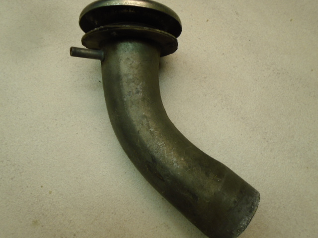

      The 64 sedan would have a non vented cap and is vented via a tube from the filler pipe, it is non vented because of its location, when you accelerate gas would spill out the vent. The Wagoneer has the fuel cap on the side at right angles to the fuel and will not spill out therefore it can be vented.Click image for larger version

ID:	1724245This is a fill neck from a sedan it is very short you can see the vent tube from the side, the tube is the vent tube.
