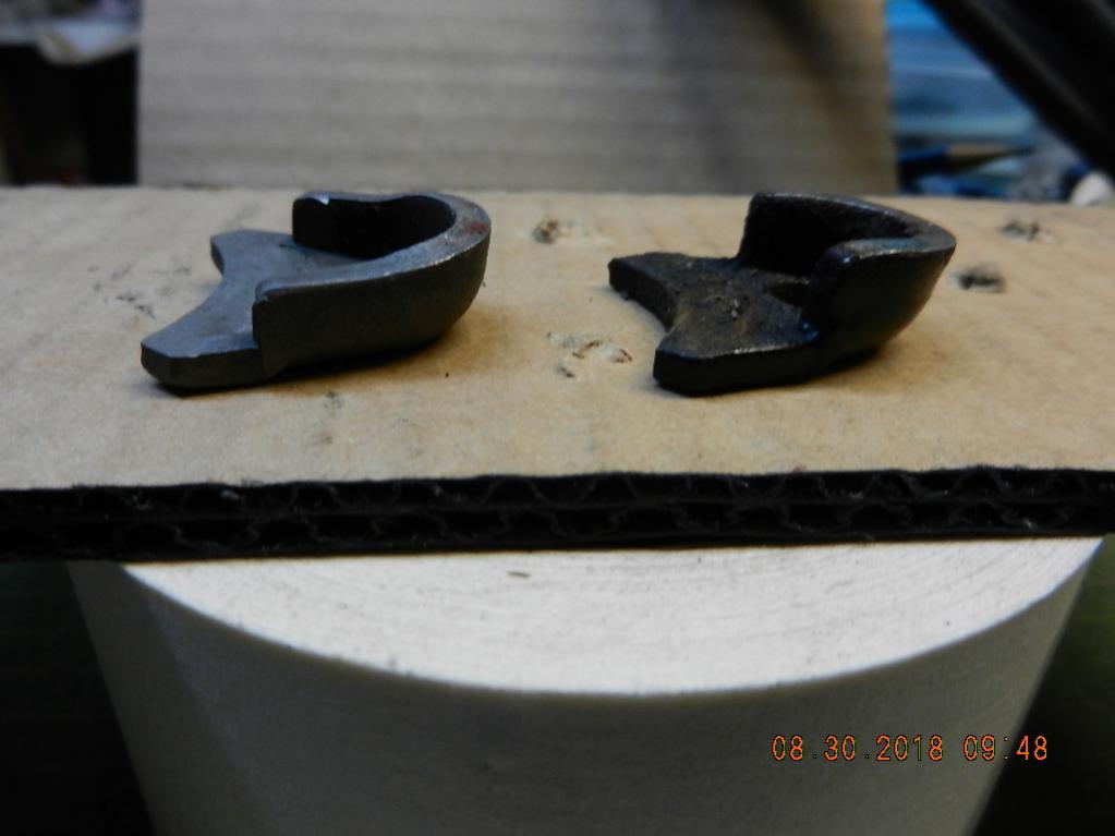

          I did discover that there are differences in the piece that holds down the distributor. I had to grind the slot on the bottom one to make it work with the earlier distributor.
          The darker one was with the two piece and the bare one was on the one piece distributor in the car. I ground the slot in the bare one closer to the edge with a burr in my motor tool. No picture of that. Once it fit I didn't want to remove it.
