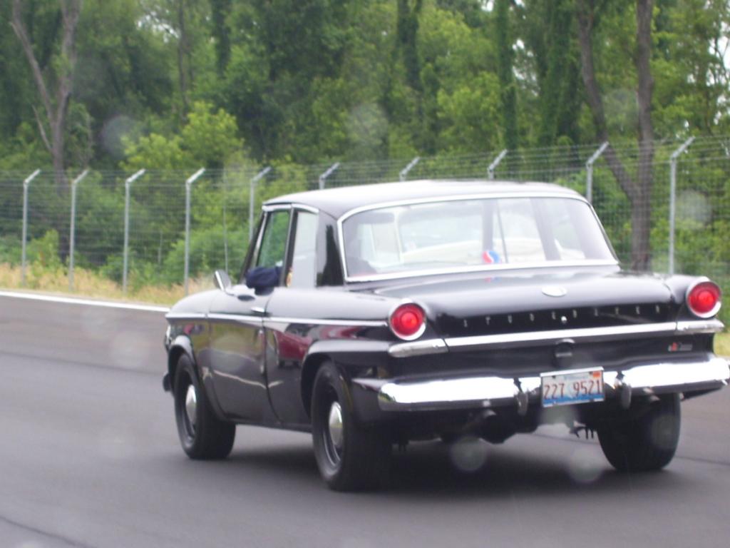

      My daughter's 64 Daytona with 15 X 7 cop car wheels. Fit is perfect.
      It appears that you are using standard MOPAR hub caps and not the police/taxi car style. I think that the standard ones, without holes, look better on that sedan.
