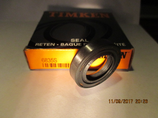

    I wasn't impressed with the replacement shaft seal that came with a pump kit I sourced from Dave T. The original 1548212 seal design is a lot more robust and I wanted a duplicate. Older threads on the forum had the same issue so I decided to hunt around. The Timken 6835S seal looked like a good choice and, at $7.96 on Amazon, seemed worth a shot. The seal surface design is identical to the original - here's a picture.Click image for larger version

      It's only fair that I share. I've gotten a ton of good info from the experienced members of the forum.
