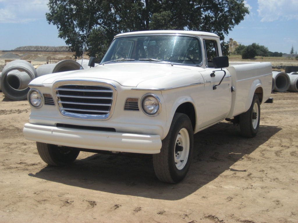

            This truck is a 16K mile original, but it is hard to tell if there is a difference between the white bumper/wheels and the Parchment White paint.
              Are "they" saying that it has not been repainted in all these years though?
              That Truck would have to have been in a Time Capsule, it looks perfect!
              Sure looks like a Match to me... Hmm?

                    It is nice...supposed to have been ordered by a dealer in Wyoming to use as a camper.
                      Tinted front windshield and spring clamps on the heater hoses.
                      Very nice survivor.
