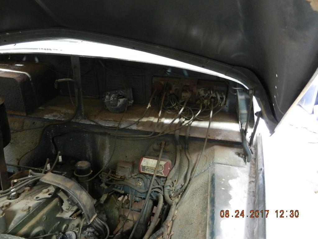

The truck had this device on the firewall, but I think it was some kind of adjustable voltage regulator. The printing was faded.
