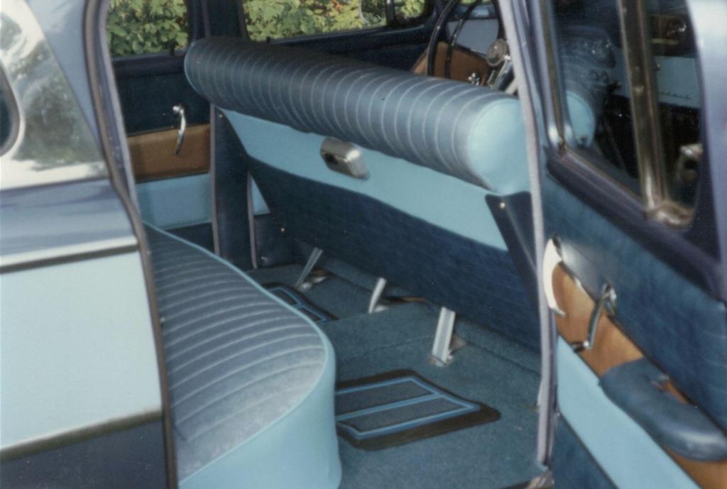

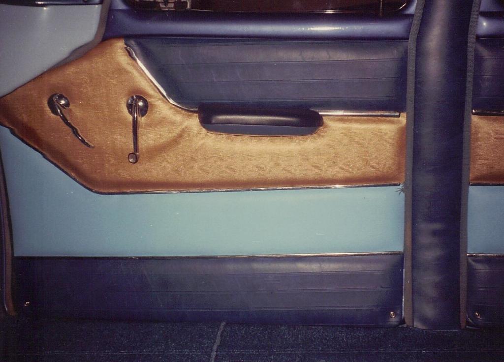

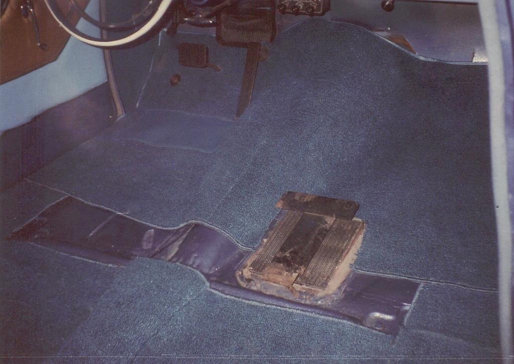

                        The wife and I did the rear shelf and door cards with vinyls we bought at a fabric store using our home sewing machine and I put in the purchased carpeting in our 1957 President Classic. Had the seats done and installed professionally with fabrics of my choosing. Too much work for amateurs. Used new new cardboard for the doors and glued down thin foam sheeting first to give it a three-dimensional look and used original clips with very few chrome screwheads and washers showing.
                        Wouldn't mind knowing where the car is now! S/N G-7198421.
