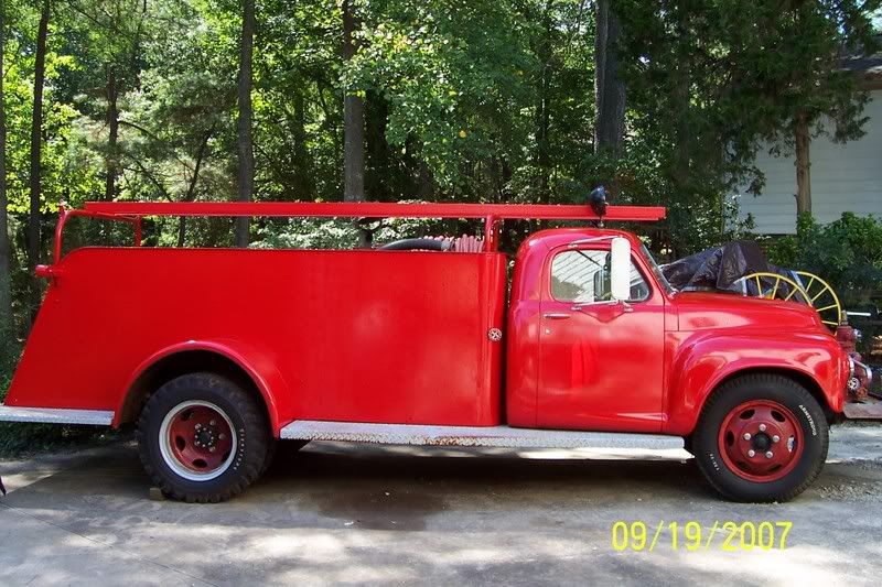

      Does it roll just like house paint? Here is a picture of my '49 fire truck after two hand rolled coats of Rustoleum Safety red.
        Does it need a special primer for proper adhesion?
