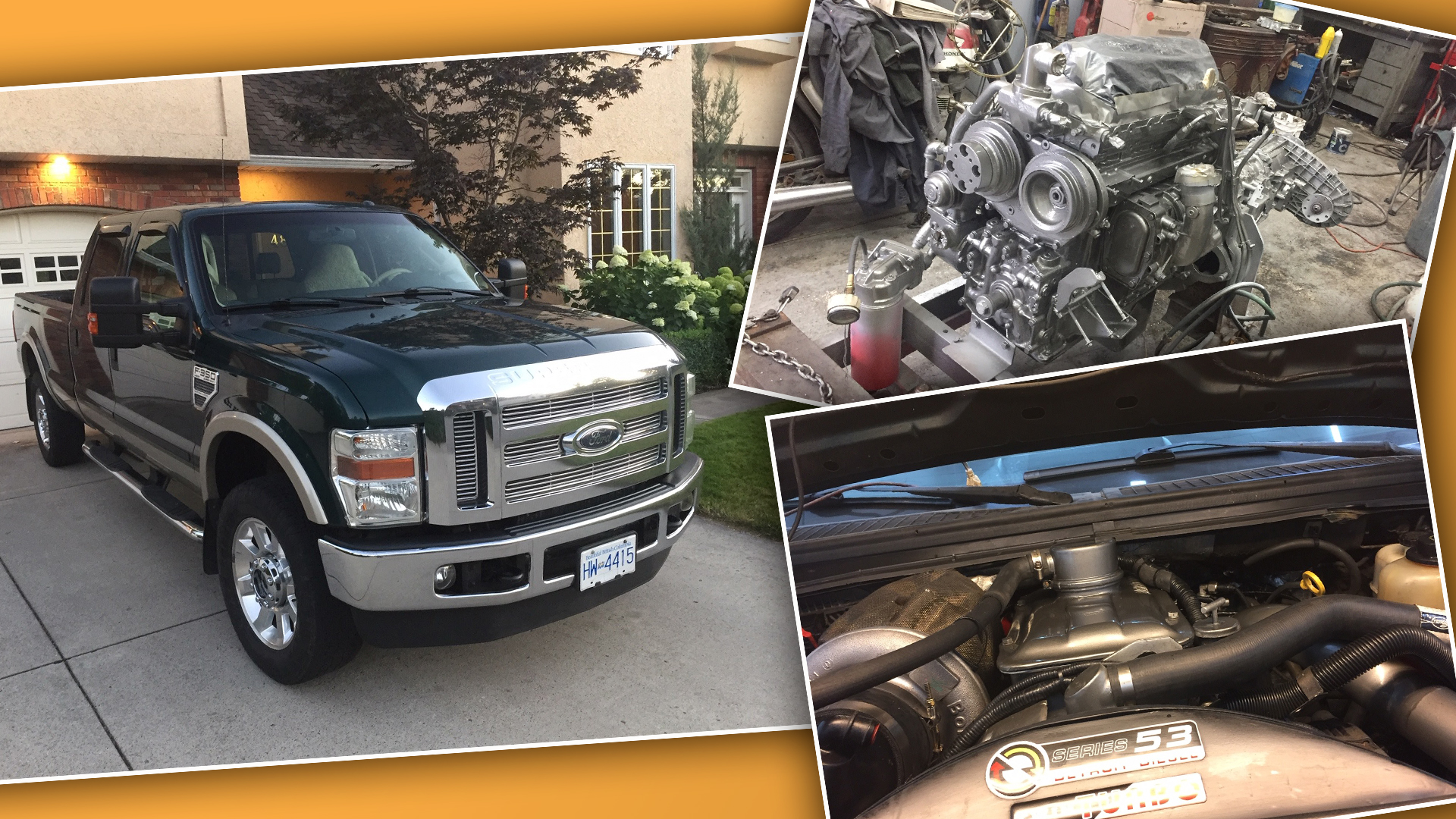

    Move over Studebaker truck, there is another 4-53 powered truck on the road now. Though this engine is newer as it is a 4-53T (turbocharged) version, I assume it is very similar to the 4-53 that Studebaker offered.
    In the middle of MinneSTUDEa.
    Technically interesting, but logically inexplicable.
    the Power Stroke started blowing black smoke uncharacteristically and, as it turned out, the injectors for cylinders one and two were stuck partially open.
    His 6.4 Powerstroke needed a couple of injectors replaced, but instead he spent $10,000 swapping the obsolete 4-53 to make his truck heavier, slower, less powerful, less efficient and noisier?

      I thought the same thing Jack. Despite what the article claims, I don't believe that the engine weighs 1000 lbs more than the original engine, but it was still a poor choice of engine.

        Although the engine sizes up at just 212 cubic inches, or a hair under 3.5 liters, it weighs around 1,300 pounds on its own thanks to its cast iron construction."The truck weighs 9,200 pounds with the Detroit in it," Park said. "It added 1,000 pounds [over the 6.4-liter]. I went overboard on the soundproofing ... I used lead on the firewall, 16-gauge sheet lead, and that really helped."
        The Detroit 4-53 weighs 1220# dry, per the Studebaker Truck Specification Book. The 6.4 weighs no more than 720#, so 500# difference.
