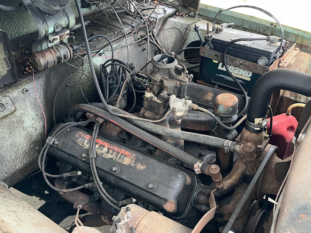

        I went through the distributor, plummed a gas can into the carb, and it started up and ran. The transmission works well enough to at least drive it around the yard. The brakes are (sorta) functional too.
        And that's it for now. I'll tuck it away until the Daytona project is finished.

              That is very rare to have an Automatic in a Transtar, but rarer yet in a 3/4 Ton.
              It must have had a engine swap if that engine is really a 224 Route Star, as they were used in '55 and '56 but as far as I know and the Parts Catalog shows, not in a '57.
              The Transmission cooler is really special on C Cab Trucks, it was not at the radiator but under the cab, and of course it was a Low gear start. And if it came from a '55 or '56 with the engine, it should be a Detroit Gear, not a Flight-O-Matic.
              Some kind of "Special Order" or a very early '57 with leftover '56 Parts ? OR, someone just liked those Cool '55/'56 Decals.
                The automatic can stay, but I'll be swapping the 4.10 ring and pinion for something a bit taller. Luckily, Dana 60 parts are very easy to find.
                Aside from a cheap repaint, I think everything on the truck is exactly the way it was in 1957. The engine has a 3Exxx serial number which falls in line for a '57 259. It has the Flightomatic trans with modulator valve and external oil cooler plummed into the heater hose ports, as shown in the parts book.
                The engine valve cover decals read "Power Star".

                  Who knew there were "Power Star" 259 Truck engines AND Decals that have never been reproduced !
                  An Opportunity there, for Both; Power Star 259 and Torque Star 289 Decals !
