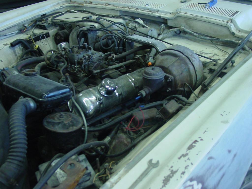

    Well my new to me R-2 Avanti got here today from WA. No brakes. Understandable after sitting for 32 years. My first step is get it to run and brakes to work. Then see if those will be exceptable as is or if one or both need a total rebuild. Needs a new windshield and some new rubbers. Small amount of body repair and a complete paint. So I now have two winter projects to do. should keep me busy all winter and out of any kind of trouble. Click image for larger version

      Got the car in the shop yesterday. planed to pull all the plugs and oil down the cylinders good before trying to turn it. Think I got lucky. The wires where all off on the drivers side and all plugs where in just finger tight. looked to have been prepped when parked. Turned easy by hand so hooked up a battery and it spun over easy with a hit at the starter. Going to try to spray clean the carb and put new plugs in it and see if it will start off a gas can. Oil is blacker than hell but right at the full mark and other than black looks clean. Got a little reassembly before I dare try to start it. Took the hood off because it will have to come off to repair front anyway and a lot easier to work on it with out it being in the way. Car appears to have been hit before in the front before. Has a 63 hood and hood prop has been moved to the left side like a 63.
        Well I can report after 32 years it runs. Had to put in new plugs, cap and wires, Ordered points and rotor and they came late today. Put the radiator back in and got everything hooked up but the fan because that was not in the pile of loose parts that came with the car. Have had it running for maybe ten minutes total so far . Has good oil pressure , 60 cold and temp got to 160 because that's what I put in for a new thermostat. only have water in it but will drain that as soon as I get everything checked out and put in the antifreeze. Oil pressure stays right at 55-60 even after it warmed up. Runs and sounds good but running way rich easy to understand after sitting so many years, Surprised it runs at all with nothing but a spray of some carb cleaner. Think I will have a local carb shop rebuild it this winter. He said he has done a few of them. Got some exhaust issues. Fuel pump works even after sitting and no gas getting into the oil. At least not yet. Super charger turns free but took off the belts and will remove it and clean and change oil before I try to hook it back up. Will run it some more and then change the oil and filter. Starts almost on the second turn so that makes me feel good. Another day of playing with it and I think I can move on to the brakes.
          On the R2, that carb is under pressure from the Supercharger. 4 lbs of boost. Make sure whoever rebuilds it is aware and capable of doing the work or the carb will spew gas everywhere. I ran into that with my rebuild.
          Sounds like good progress is being made.
            He knows it's a R-2. Said he has done a few. His Dad started the shop years ago and when I ran my Dads engine rebuilding Shop we had him do a few. Always did a good job. The son took over when the old man retired. I think they do rebuilds nation wide and ship all over the country. Said if it's just a clean and new kit somewhere just under $400. Will have that done over the winter because can tell by how it runs and how rich it's running it needs it plus the back two of the 4 bbl are stuck. Kind of common on AFB's when they sit a while. Had it done on them before.
              Before you put it back together, make sure the radiator core support mounting brackets to frame are sound and not broken or cracking. They literally support the front body, and the fact that it's been tapped in the front maybe once or twice makes them a potential problem.

                Checked it today and they are solid on both sides. Thanks for the heads up.

              Please be aware that your carb shop may not have the exact rebuild kit for your car, too many "think" an AFB is an AFB:-( Better to have either Dave Thibeault or Jon Myer rebuild your carb....................just saying:-)
