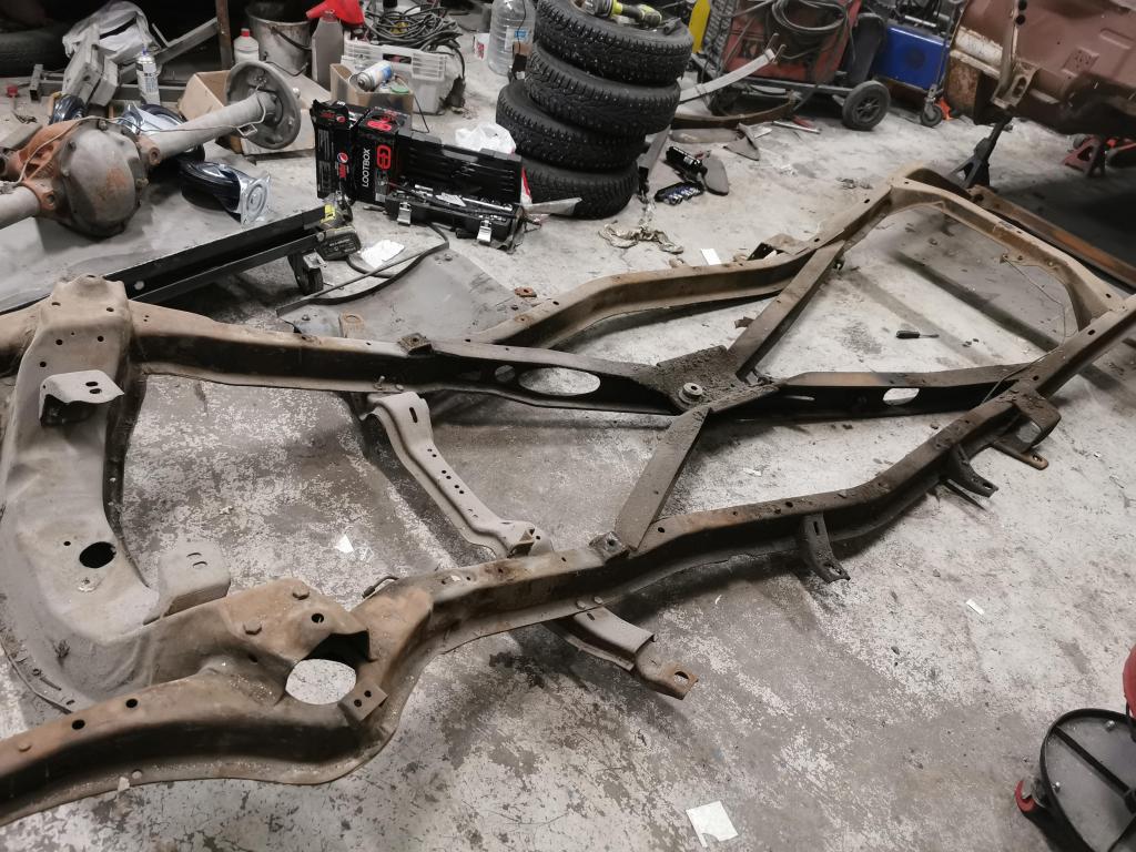

      frame is in excellent condition, just needs sandblasting and paint.

                Next job on the to do list: Clean the frame
                Done. Took me almost 8 hours to get this properly cleaned. Still amazed how sturdy this thing is
                Aaaand painted!
