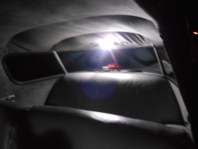

    Just had some 12v LED interior light bulbs delivered today.
    Just had to put them in the 50 Starlight and see the results
    Oh boy what an improvement over the old original yellowish bulbs
    Now I`m sure I will be able to actually read a map at night !!!!!!
    Taken in daylight and now at night last picture is taken from the front looking through the windshield you can see how bright they are against the room light to the right of the picture

    These fit the original dual contact sockets
    Geoff

      These were a sample prior to an order.
      They will be $15 for both the dash light and the rear light when they arrive.
      The voltage range is 9 to 14 volt with a 27 LED chip 6000k super white brightness
      Geoff

              Did you convert the car to 12 volts, or are the LEDs working on 6 volts?
              Yes Roy I converted to 12 volt neg ground.
              But they may also work on a charging 6 volt being there volt range is 9 to 14 volt, ground won`t matter as it will just be a case of turning it 180 if it doesn`t.
              But mine worked straight away I didn`t have to try turning them.
              Geoff

                      Yes they do just change directly over keeping the original interior and dash map light sockets
                      Geoff

                        Also care must be exercised in the amount of LED`S the bulb has when it comes to the rear number plate light,too many and it will not go in the housing due to the length.
                        I`ve also illuminated the hood spear on my 50 Champion using a BA9s 5/8 dash socket and various colored LED`s from White,Blue,Amber,Green or Red Click image for larger version
