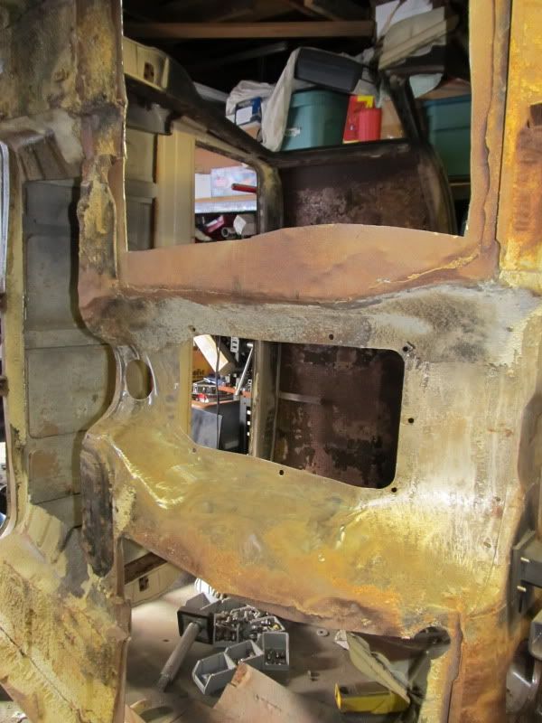

          You will find that those pans are made to have the old ones removed completely, especially the front 3/4. If the floors are rotten the rockers will have to be replaced too. This is mine and I had to do it on a rotisserie, not a fun job.
